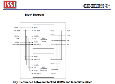

I'm working on a hardware design using the STM32F765VIH and I am trying to connect a MT28EW128ABA1HPC-0SIT NOR Flash and IS66WVH16M8DBLL-100B1LI PSRAM to the FMC in muxed mode. I'm struggling to understand how the muxed connection should be made and although I've searched a lot I cannot seem to find any reference schematics for this.

The PSRAM appears to be HyperBus interfaced; FMC does not support HyperBus. The 'F7 family does not have OCTOSPI interface which supports HyperBus, read AN5050.
mƎALLEm
Not sure how do you plan to connect a HyperRAM to the FMC interface! The protocol is quiet different!

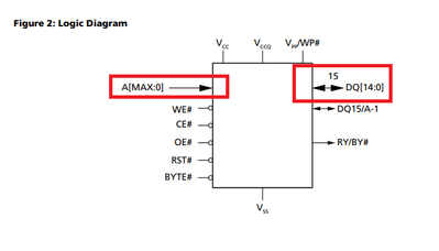

Regarding the NOR Flash, FMC muxed mode needs either a memory having natively a shared Address-Data lines (which is not the case of IS29GL128-70) or you need to add external latches to hold the address during the read/write operations.
Sorry I had specified the wrong part number for the NOR Flash, I'm considering the MT28EW128ABA1HPC-0SIT but regardless of the actual partnumbers is there any reference design that shows how to interface the muxed FMC to standard parallel NOR Flash or PSRAM ?
MT28EW128ABA1HPC: same thing -> No muxed Address-Data busses:
Unfortunately (to my knowledge) there is no reference design provided by ST as all STM32 MCU boards are using memories having separated Address/Data lines: direct connections data-data, address-address (no shared busses / neither external latches).
