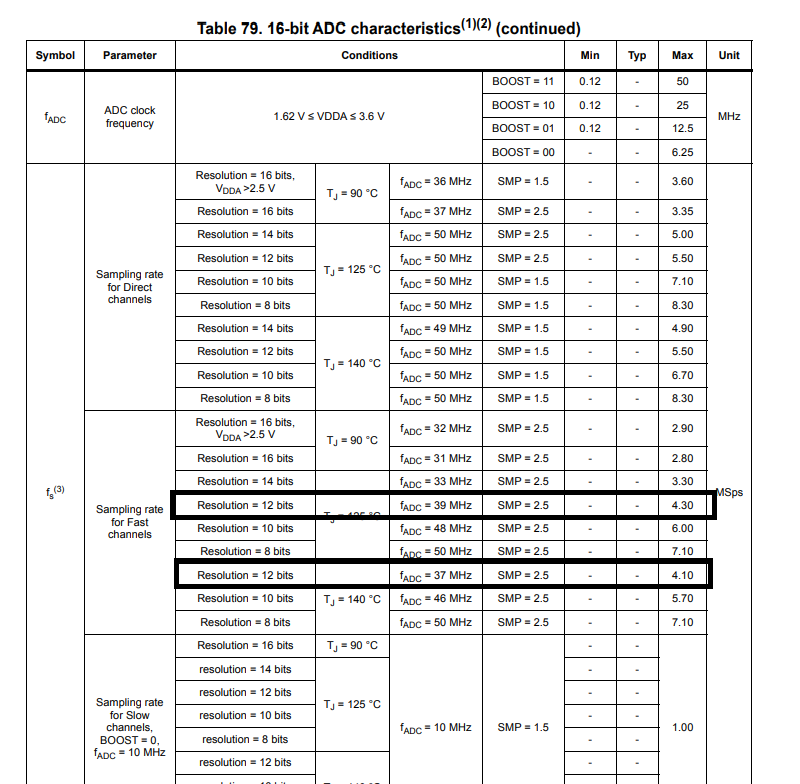

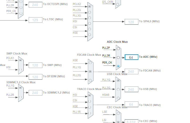

I m trying measure adc conversion time , I look datasheet , f_adc=37 Mhz(for fast channel)

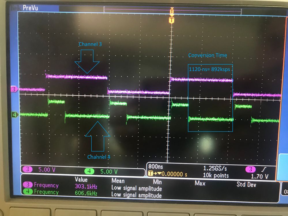

with 12 bit resulation, 4.10 MSps , so ı use f_adc=32 Mhz(for fast channel) with 12 bit resulation, 3.54 MSps should be, but I m not measure 3.54 MSps,I measure 892 Ksps My measurement is as follows, when entering dma interrupt ,I toggle pin , then I set another pin At the end of the interrupt, I reset the pin again. the difference between the two times gives the adc conversion time.where is my fault project file and oscilloscope images are attached.

			  LL_RCC_SetADCClockSource(LL_RCC_ADC_CLKSOURCE_CLKP);

			  ADC_CommonInitStruct.CommonClock =LL_ADC_CLOCK_ASYNC_DIV2;

 void DMA2_Stream1_IRQHandler(void)
	 LL_GPIO_TogglePin(GPIOB, LL_GPIO_PIN_0);// oscilloscope CH3
      GPIOA->BSRR=0x00000001;//// oscilloscope CH4
 	  if(LL_DMA_IsActiveFlag_TC1(DMA2))
 		 LL_DMA_ClearFlag_TC1(DMA2);
 		 LL_ADC_REG_StartConversion(ADC2);
 		GPIOA->BSRR=0x00010000;//// oscilloscope CH4

You can't interrupt at the MHz rates, so instead of doing ONE sample, sample 10 or 100 and decimate the time to understand the sample rate. Use ping-pong buffers with the DMA HT/TC so you aren't working on active/changing data. Watch/manage cache coherency.
You cannot effectively measure the time for a single conversion. As I said in the other post you found, time 10000 conversions to reduce the overhead.

Hard to prove a negative. The overhead on cpu timer/monitoring is on the same order as the conversion time. You cannot separate the signal from the noise/overhead on a single conversion. For many conversions, the overhead is comparatively much less of a proportion.
Well you'll saturate the MCU with a lot of context switching and all the burden you're carrying with the handlers, the HAL, and the callbacks.
The ceiling here is probably a lot lower than you think it is, and it scales very badly.
