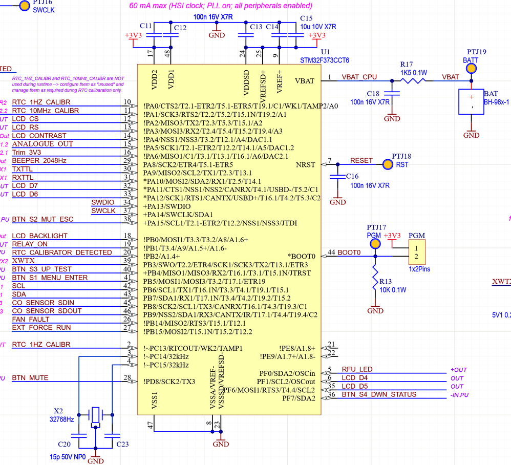

Here's the relevant section of the schematic. The battery is currently sitting at 3.13V.

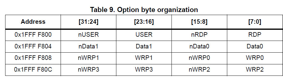

You have statement: pwDst < (uint16*)(&OBR + 1), but FLASH->OBR is uint32_t so you adding "1" you increment by 32 bits, is it expected on you?
Notice that you should not copy whole OBR because some bits in FLASH->OBR are reserved

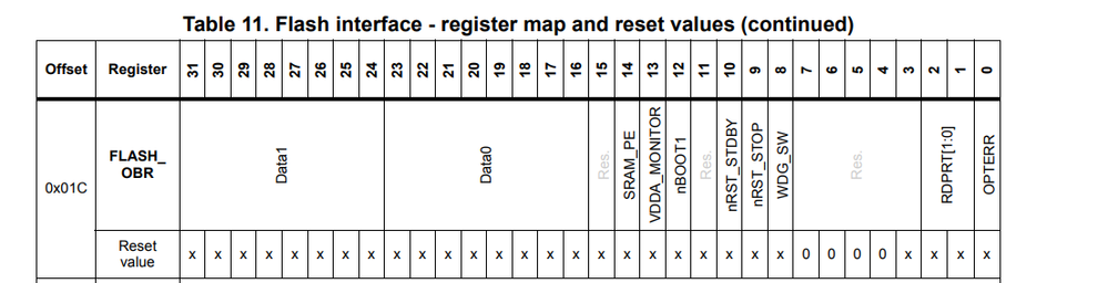

OBR is actually the Option Byte register at address 0x1FFFF800, as described in Section 4 of the reference manual. It's written 16 bits at a time, but the CPU automatically fills in the inverted side. This is, apparently, how you program the FLASH_OBR, because a reset fills in FLASH_OBR from the Option Byte Register.

What Kamil meant was, how exactly do you declare OBR? You perform pointer arithmetics in both (&OBR + 1) and pwDst++. The latter is certainly wrong, as you want to skip nDatax; the former may or may not be wrong depending on what is OBR's type and what did you exactly intended to do in the loop.
> At the end of the function, the OBR Data0 and Data1 fields show the correct values, and the nData0 and nData1 fields show the inverted values.
How exactly do you check that?
Can you show in debugger content of 0x1FFF'F800... area?

Okay, but still you write into both the "inverted" and "noninverted" portions, I don't think that's how it's supposed to work.
But, nonetheless, could you please show us example readouts of given area, before and after calling the function (plus content of the array to be written), and then after reset - or whenewer it changes, according to your initial post?

If I load - for example "e4" into Data0 and "03" into Data1 without changing nData0 or nData1, I've watched the memory area get loaded with "e4" in Data0 and "1B" into nData0, then "03" into Data1 and "FC" into nData1. It seems the "n" fields are read-only.
I have (once) seen the OBR start up showing the correct values, but FLASH_OBR is incorrect.
