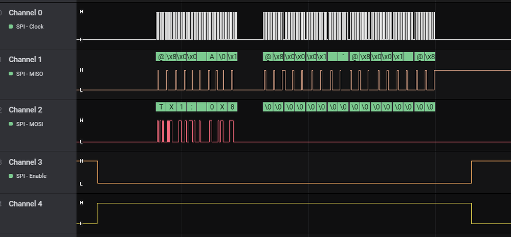

STM Nucleo Boards SPI Master/Slave Communication Problem. I set up a Nucleo-F446R as Slave Full Duplex and a Nucleo-G431R as Master Full Duplex. Master Sends -- Slave gets garbage.

0693W00000AOVMVQA5.pngI am attempting to work my way through SPI interfacing and am using two Nucleo boards to increase my understanding. At this point I am trying to do a simple polling SPI transfer from one Nucleo board to another Nucleo board. The plan is to move on to interrupt transfer and then to DMA Transfer.
I set up the clock for both boards to run at 64MHz and the SPI master clock to run at 1MHz. I am using CPOL as low and CPHA as 1 edge on both boards. i use an output pin on the master to signal the Slave to receive data. When the slave signal pin goes low, then it attempts to receive a message, modify the message and send it back. I use a logic analyzer to monitor the transfer. I have been over the wiring several time an it is correct. I am trying to
I have obviously overlooked something simple for it to be this difficult.
Any Suggestons

Your master sends:
Rslt = HAL_SPI_Transmit(&hspi2, pSpi2TxData, strlen(Spi2TxData), 200);
while the slave receives:
Rslt = HAL_SPI_Receive(&hspi3, pSpi3RxData, 16, 300);
From your scope, it looks like strlen(Spi2TxData) = 8 (and not 16), which makes master/slave out of sync.
You'll also need delays to ensure the slave is ready to send before the master starts clocking data. 2ms delay is probably enough, but use 10ms to be safe until you get things working. In addition to the delay you have commented you, you will also need a delay between the two parts of the transaction on the master side.
Also look at the return values from the HAL functions. You would have caught that the slave transmit is timing out.

I am using a logic analyzer to look at the signals (see screenshot) but I'll try looking at MISO on a scope.
I am using the default setup for the Nucleo boards and only setting up the SPI channels on both.
I have tried multiple speeds on both master and slave.
The clock speed is only settable on the master and I have limited that to 1Mhz. It should be low enough to be used for testing purposes on these boards. I've reduced the clock speed on the master to 500KHz without any change. At this speed, line length shouldn't be a factor, I would expect an occasional byte glitch but nothing like what I am seeing on the analyzer.

It's only sensitive in the sense that the slave needs to be ready to send or receive BEFORE the master starts clocking that data, as explained in the first reply. One method to debug would be to add a GPIO output to indicate when the slave is ready so that you can see this on your scope plots.
One way to resync is to interrupt on the falling CS edge and restart the transfer to realign data. Note that you'll need a delay on the master between the edge and the first clock to wait for the slave to be ready. A better method would be to ensure nothing gets out of sync in the first place.
