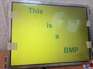

After that I made a simple 1024x768 BMP picture in GIMP (Green text ''This is a BMP'' on the yellow background), then I optimized it using Bitmap Converter, then converted it to C-array using Bin2C for GUI_BMP_Draw() function and finally got it on the screen:

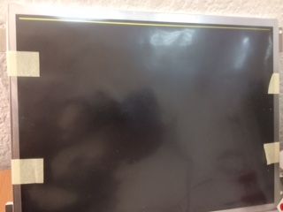

Next I made a same GIF picture (''This is a GIF''), unoptimized it as described in emWin manual (exactly in emWin
UM03001, not in StemWin manual
StemWin532.pdf) then again used  Bitmap Converter and converted the GIF to C-array for using with
GUI_GIF_Draw().
And got this one:0690X00000604k2QAA.jpg
Seems that only few first lines of the GIF displayed.
GUI_GIF_Draw()
returned 1. That is error.

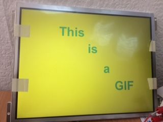

Next in function
GUI_X_Config()
I reconfigured
aMemory
location to its default address in internal RAM.
static U32 aMemory[GUI_NUMBYTES / 4]; // __attribute__ ... deleted. Watch window shows 0x20001308 address.
Had to reduce the size of aMemory to
300 KB
as internal RAM is only
512 KB
on the chip:
#define GUI_NUMBYTES
(300 * 1024)
Frame buffer location for layer 0 remains unchanged:
#define LCD_LAYER0_FRAME_BUFFER 0xC0400000 //
in SDRAM
C-array containing GIF data also remains unchanged. The only change is
aMemory relocation from SDRAM to internal RAM.
And got it:0690X00000604cPQAQ.jpg
GUI_GIF_Draw()
returned 0. Works fine.
