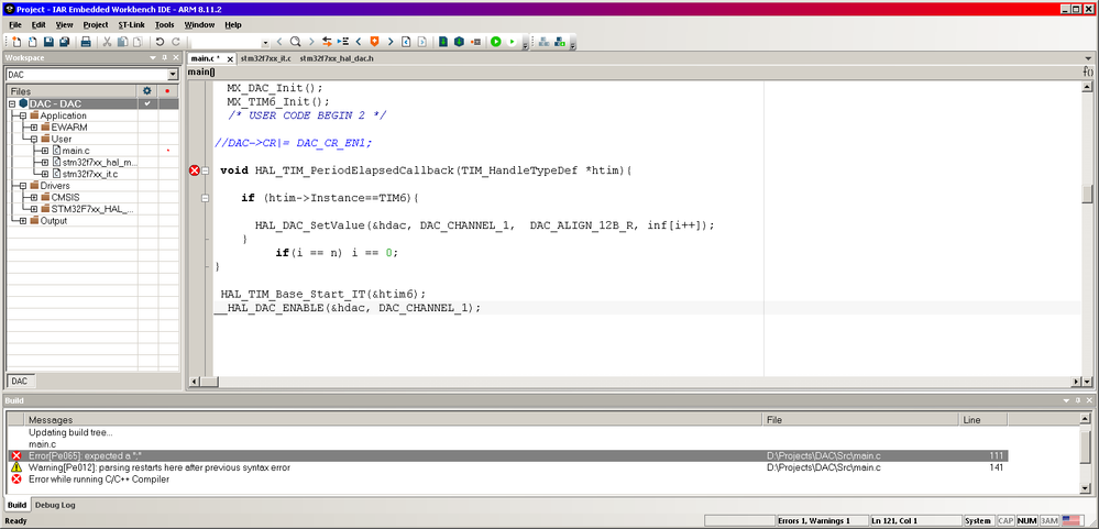

Posted on June 02, 2018 at 09:43
  Thank you for reply, Laurent! I drew my attention to the examples I had seen before and noticed there are no any *for* loops in callbacks. I understood my mistake I changed the body of the callback function. It may sound foolish but I got strange syntax error, whereas code seems to be syntactically right.
   As far as I'm considered I may also place my piece of code in the TIM6_DAC_IRQHandler() function  which is declared in the separate source file for interrupts. Though, results are poor.
   What might be wrong with code on the pic? Could you please clarify the difference between the callback function for my timer and interrupt handler?
   I'm new to MCU's so I say sorry for my silly questions beforehand)
Posted on June 02, 2018 at 09:53
It was my mistake again! I should place the callback function outside main().
P.S. if (i == n) i =
