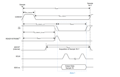

This is the timing diagram for the ADC
What would be the best way to trigger the timer when the GPIO connected to ready pin changes, with less delay.

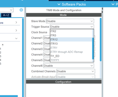

What is ETR, I know the ITR is for master timer to trigger slave timer?
@TDK @gbm

Normally, one uses timer output to start the conversion, then, after the result is ready, it should be read using SPI. Conversion time + reading time must be >= conversion cycle time.
It's you who decides on starting the conversion and on conversion frequency, not the ADC.
My STM32 stuff on github - compact USB device stack and more: https://github.com/gbm-ii/gbmUSBdevice
I would set up a pin as EXTI to trigger a write to SPI when the ready pin goes high. Add DMA to read out the content of the SPI. Let SPI control the CS pin. It will pull it down, do the transaction, then set it high again.
waclawek.jan
The original description sounds to me as a single-shot, i.e. I'd use TIMx_CH1 (or TIMx_CH2) as Input (technically set to Capture) to the Slave-mode controller, set TIMx_SMCR.TS to respective TIxFPx, set TIMx_SMCR.SMS to Trigger, set One-Puse mode i.e. TIMx_CR1.OPM=1, set one of the remaining channels to Output Compare/PWM, and set its Fast Enable bit (TIMx_CCMRx.OCxFE=1). That would generate the complete pulse, but that won't start SPI.
If SPI would need to be started, I'd probably try something along DMA triggered by TIMx_DIER.TDE transferring some dummy data to SPI_TXD to start read transfer, but the 'H7 SPI is exorbitantly complex and I don't know its ins and outs, I don't use 'H7.
In other words, I believe this could be automated to run entirely in hardware; but details have to be worked out, based on deep enough knowledge of the chip. This may be clickable in CubeMX, if one knows where to click... but maybe not. I'm not a Cube user.
