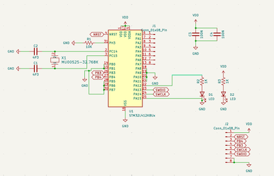

Here is the schematic:
See, extremely basic!

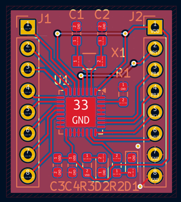

Here is the layout:
I'm using a V2 (not a V2 ISOL). On the 20-pin header I connect:
7 - SWDIO (my pin J2.6)
9 - SWCLK (my pin J2.5)
15 - NRST (my pin J2.2)
20 - GND (my pin J2.8)
1 - my pin J2.1
When I try to program, I tried all 5 reset modes, but I notice the power doesn't even come on during programming. I tried using VDD 3.3V pin 19 to my pin J2.1 VDD, and my test LEDs light, but the device is still not found.
Either I messed up the schematic, did a bad solder job with the components, or I'm not setting up the IDE studio debug config correctly.
What is the next level of debug I should investigate? I'm stuck.

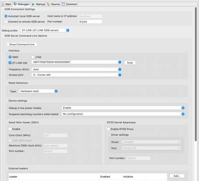

Here's my debugger config (I tried all reset options):

‎2024-07-03 11:11 AM
Thanks Peter.
I turns out I had the right orientation, but the rubber shrink wrap tubing had slid down the black wire and it wasn't making contact with the pin! In addition I also need to run the voltage back from VDD to Pin 1 of the V2, and use software reset.
It works, I'm pleased.
Thanks, for the help, I wouldn't have thought about that pin 1 VDD target issue.
‎2024-07-02 10:48 PM
Welcome @stmdude, to the community!
J2.1 is a ST-LINK connection to measure the voltage at the (your) target, NOT to supply it.
Can you also upload photos (front and back) of your ST-LINK/V2?
Regards
/Peter

‎2024-07-03 8:41 AM
Thanks, yeah, great. I just wanted to make sure you didn't have one of those colourful ST-LINK clones in a tin can, which I'm pretty sure it can't work with.
But as I said, the ST-LINK/V2, pin 1/2, can't power your board, you'll have to do that externally.
You should also connect your target correctly to the ST-LINK, as your purple wire is connected to pin 8 and the black wire to pin 10, both of which have no function. In UM1075, figure 10, pin 1 is shown somewhat confusingly. The best way to remember the position of pin 1 is to look at fig 9, where the red stripe of the ribbon cable marks pin 1 -- figure 10 must be viewed rotated by 180°, so to speak.
Hope that helps?
Good luck!
/Peter
