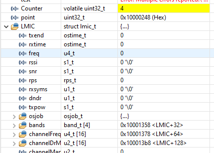

Hello dear STM32-Community,
I'm using an STM32L4R and wanted to configure my data retention of SRAM2 for standbymode.
I did the following changes to the linker file:

As seen on the screenshot the data is acutally saved in SRAM2 (0x10000000) 0693W00000KbduWQAR.pngbut except for counter, which is specifically initalized with
volatile uint32_t Counter __attribute__((section(".sram2")));
everything else is reset after restarting the programm. What am I doing wrong? Or do i have to manually enter every variable to sram2 myself?

How are other SRAM2 variables initialized.
Is SRAM2 marked as NOLOAD?

The others are just initialized like usual:
float temp = 0.0f; and so on. As stated in the linker file, they are saved in 0x1000000.
And what does NOLOAD mean and where do I find that?
Thank you for your reply.
Kind regards
Google?
Similar to NOINIT (don't initialize)
So that code in startup.s doesn't zero or copy in statics you don't want initialized.
If you’re initializing them, it would make sense that they would be reset at startup. You need to mark them as no load and initialize only if needed.
