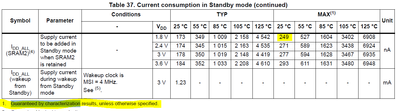

For the consumption, the typical values are based on one sample and we know that there are a variable between samples from the same family. This is why we provide the maximum values which are guaranteed by characterization and take account all the possible variations.
The maximum consumption value for the Standby mode at 25°C 1.8V + all SRAM2 retained is 368nA.Aime_0-1688914309978.pngAime_1-1688914377881.png
The 277nA is still lower than the maximum value I think your setup is clean and has no leakage.
I agree with you the temperature has a effect on consumption mostly on Standby mode where most part of the system are powered off.

Without RTC the figures would be within the limits, yes.
But with RTC (datasheet figures):
Standby with LSE low drive: 281 nA (no max value specified)
SRAM2 max consumption: 249 nA
That's 530nA in total. I'm measuring between 590 and 600 nA.
Hi @ramses946 ,
We can not guarantee the maximum values on LSE tests because of the hardware constraints in production.
This is why we don't have in datasheet the maximum values for the Standby with LSE in low drive mode.
I think the over 60nA - 70nA that you are measuring are due to sample variation.
Best regards,
Aime

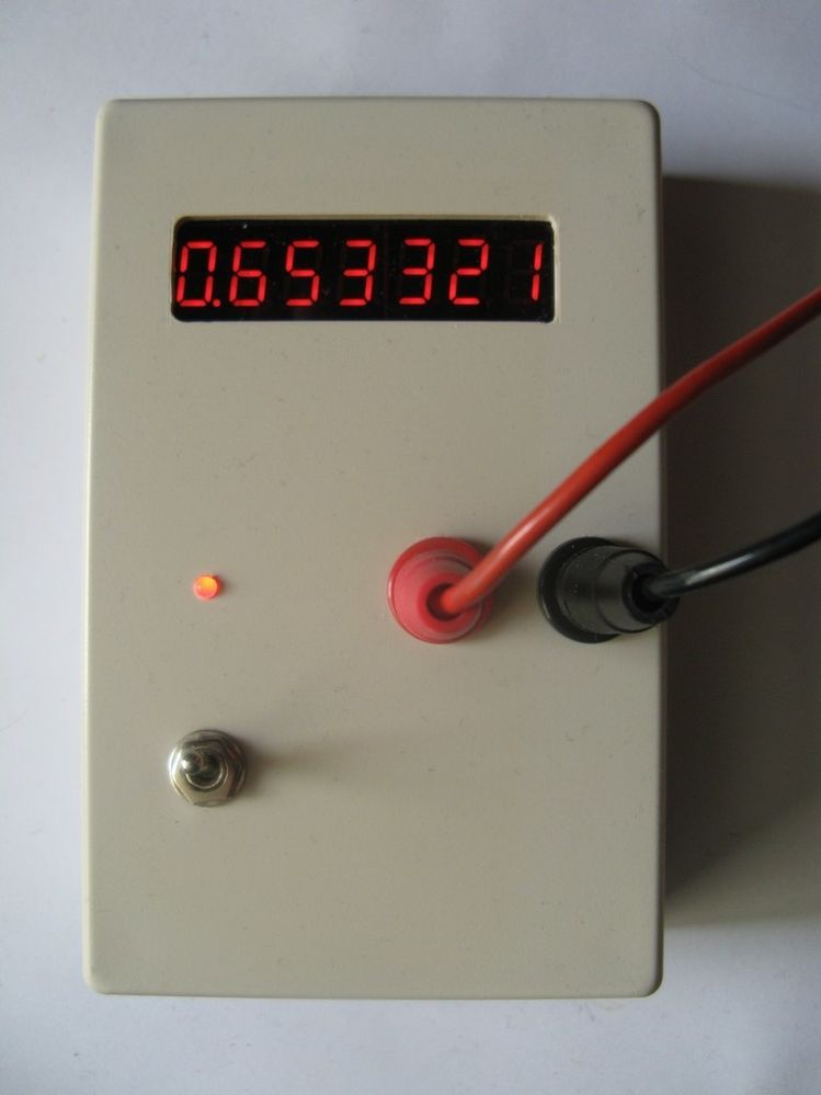

About frequency measurement, it might be interesting to see this project, maybe using a TCXO of 0.1 PPM is better than common crystals:
https://www.instructables.com/High-Resolution-Frequency-Counter/
