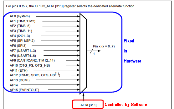

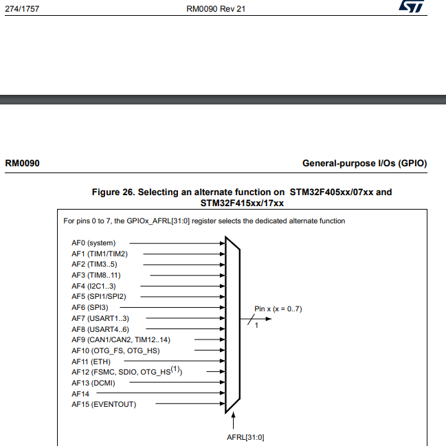

As you can see from the tables, each pin can be configured to a number of Alternate Functions (AFs).
The range of possible AFs on a given pin is fixed in the hardware.
Selecting which one of the available AFs to use at a particular time is done by the software; eg, via HAL functions
‎2025-01-10 8:14 AM - edited ‎2025-01-10 8:21 AM
This is shown diagrammatically in the Reference Manual; eg,
PS:
Highlighting what's defined by hardware vs what's controlled by Software:
‎2025-01-10 8:19 AM
