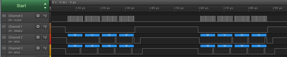

I'm trying to transmit 4 16-bit words via SPI as slave using interrupts and HAL.
I'm using STM32F107VCT6
So I specified a buffer:
uint16_t buf[] = {0x000F, 0x00F0, 0x0F00, 0x0004};
And started to transmit in main:
MX_SPI2_Init();
HAL_SPI_Transmit_IT(&hspi2, (uint8_t *)buf, 4);
while (1)
      //some logic
Spi was initialized with CubeMX:

That is what I get:
What am I doing wrong?

Your code sends the 4 halfwords ONCE.
Is the LA picture you posted the FIRST transaction after the slave has been reset?

Thanks for the answer!
You are right, first transaction is correct.
What is the correct way to transmit data "by request" using interrupts?
Is there any way to get interrupt by hardware NSS?
waclawek.jan
There's no "one correct way", it depends on your application.
Use EXTI interrupt - Cube will get into your way. It's a recurring theme her, search, there's among others also a quote recent related thread.
