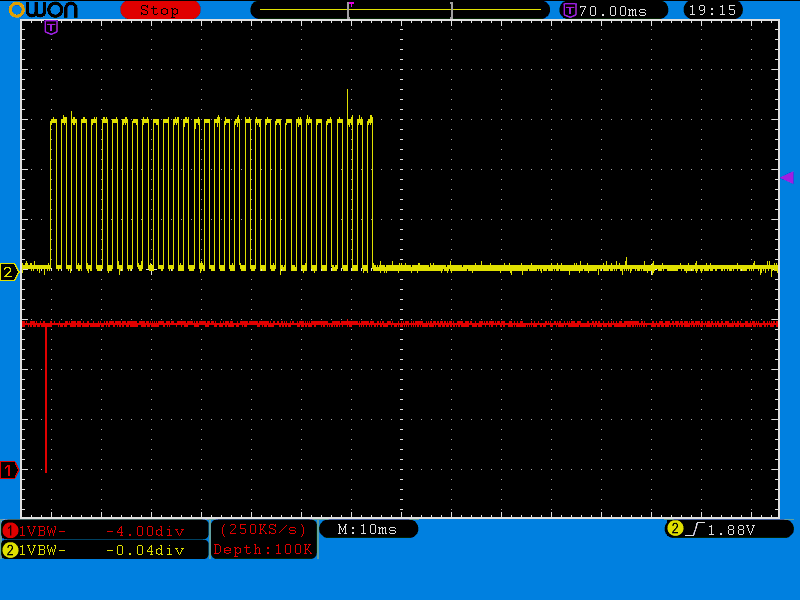

Here's whats happening: 0690X000006053jQAA.png Yellow line is hardware SPI_CLK, Red line is software SPI_NSS. Code is basically this:
HAL_GPIO_WritePin(M25P80_NSS_PORT, M25P80_NSS_PIN, GPIO_PIN_RESET);
HAL_SPI_Transmit(&hspi1,
out
, 4, TIMEOUT);
 HAL_GPIO_WritePin(M25P80_NSS_PORT, M25P80_NSS_PIN, GPIO_PIN_SET);

Chris1
Senior III
Posted on February 23, 2015 at 18:30
You should wait for the transmission to complete before raising CS, as indicated by the SPI status register:
    // wait for transmission to finish
    while (!(SPI1->SR & SPI_I2S_FLAG_TXE))
    while ((SPI1->SR & SPI_I2S_FLAG_BSY))
    HAL_GPIO_WritePin(NSS_PORT, NSS_PIN, GPIO_PIN_SET);
I don't know if there is a HAL function for this.
stm322399
Senior
Posted on February 23, 2015 at 19:00
What about using HAL_SPI_TransmitReceive, even if you do not care about the reception. The nice thing about reception is that when the last character arrives, then you are sure that the transmission is done.
