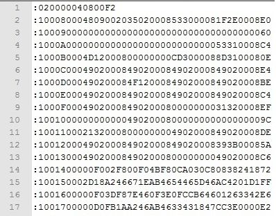

My Keil compilation makes 2 files:.axf.hexWhat file shall I use? Any one has done it before?My second questions is what interpretation (Addresses mainly) should I do with my hex file?

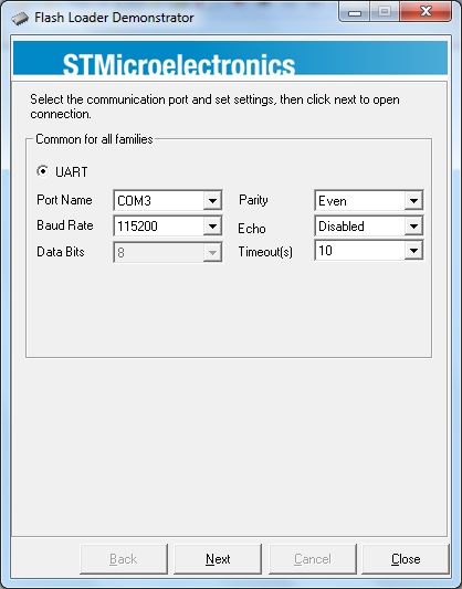

I´m trying to update my application with the Preprogramed bootloader by apropiate uart and pins BOOT1/0 according to that task.I could use this application to do that, couldnt I?

1.First,you need to confirm the boot setting that the boot0=boot1=1
Second,you need to reset your targer broad once that's okey,you can download programm to your MCU.2.You don't do anything,this HEX file is correct.Options
Everyone but you, it will accept .BIN and .HEX files, it will not accept .ELF or .AXF Object files.Code at 0x08000080 isn't really bootable code. There is plenty of documentation about the Intel Hex format going back to the late 70's
