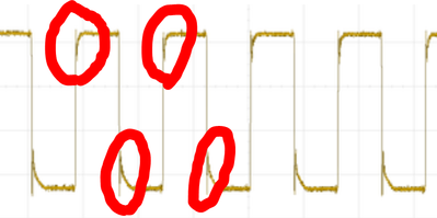

I am having weird issue with STM32F767 (configured to run at 200mhz) that needs to be SPI slave .. I configured it with 0,1 (clock low, second edge), hardware cs.. when master sends data at 350kbps everything is ok, when master sends at higher speeds output is random (like bits are swallowed).
code is super simple just hal_spi_transmitreceive() in a loop sending 2 same bytes non stop
it behaves like hardware can't catch up and start sending data late and slower than the clock...

>looks like some phantom clock is happening
maybe ringing ...try a damping R , 75 ohm in the clk line ; before + after adum.
i had a big problem with a fpga and its 50MHz clock, just close, 15mm track.
sometimes work, sometimes crazy errors.
after days (!) i tried a 50 r inserted here - and runs perfect then. unbelievable.

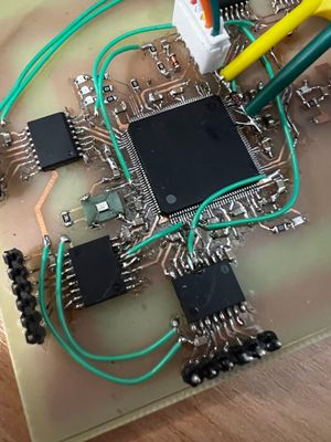

we planned to add resistors to test but when I look signals under scope I do not see any issues .. and also at 400khz at few mm I do not see htf can any ringing happen but.. after all the @#$()&^@ on this project I can believe anything at this point... wasted weeks on something that was in reality 2-3 hours of work :( all 'cause of pcb issues :(
Really can't imagine this is a PCB/interference issue at 400 kHz if the chips are 10 mm apart.
You have some weird bounce happening on the clock. Initial edge is super sharp, but then it bounces back and goes slowly to the rail. Could be a miscalibrated scope.

as for "can't imagine this is a PCB/interference issue at 400 kHz if the chips are 10 mm apart." ... it is hard to imagine how bad pcb can be... our post is in strike for few months so can't order anything so we made it in-house and changed whole bunch of things after the fact so now it looks... well ..

ah that would be the first thing to try if I could but my eyesight is going haywire so any changes on the pcb I need to call someone to do it so it takes a lot of time and I'm afraid this pcb can't take much more abuse :( I think it is time we make a completely new one and transfer the mcu... additional issue is we do not have enough mcu's and can't order more... this whole project is .. uh.. anyhow, great ideas, I have bunch of things to test now :D
