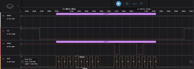

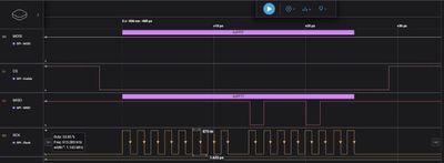

So I should see on MISO line 0xF77F non stop.

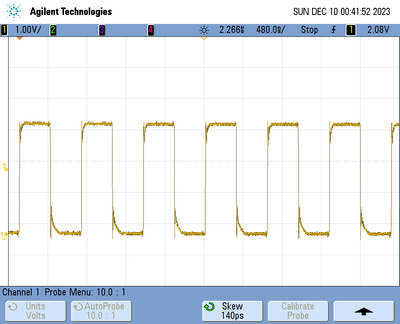

What I see is same "shape" as 0xF77F only looking at some random clock. here is from LA at two different speeds of the MASTER:

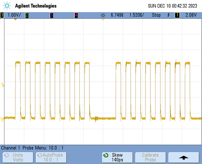

and the scope on the clock directly on MCU pin (slave mcu) looks ok, not super perfect but ok

also, connections are rather short, between adum isolator and mcu is maybe 10mm, then after adum I have 5-10cm of wires only... so I doubt it's the issue with wires but I'm open to suggestions banging head with this for days

sending F77F
looking at both 666khz and 1.2mhz I see FF77 .. so first nibble is ?!?!?! then I have ok F77 and then I'm missing a nibble .. like whole word is "nibble late" ?!
CS is properly going up/down as expected and SPI is configured to use HW CS (

not sure I understand "spi slave's reset negation" - can you elaborate?
