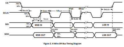

The datasheet doesn't suggest any need for delays:
‎2024-04-15 8:24 AM
Test your code on e.g. a Nucleo board and connect MOSI to MISO with a jumper wire.

‎2024-04-15 9:34 AM
that's within the timing of the hardware peripheral - not a software delay between read & write.
‎2024-04-15 9:50 AM - edited ‎2024-04-15 9:57 AM
(after 30 mins on ds ...)
1. spi clk mode is wrong:
set : cpol hi + cpha 2edge (as i see from this timing diagram)
+ set in Cube/ioc :
2. command / response
I would use :
/*HAL_SPI_TransmitReceive(SPI_HandleTypeDef *hspi, const uint8_t *pTxData, uint8_t *pRxData,
uint16_t Size, uint32_t Timeout) */
uint8_t TxData[16], RxData[16];
so:
TxData[0] = 0x91 ; // read : whoami
HAL_SPI_TransmitReceive(&hspi1, TxData, RxData, 2 , 50);
The response should be in Rxdata[1] then.
3. set spi clk to 1 MHz or so, faster is no problem - if it works fine.
