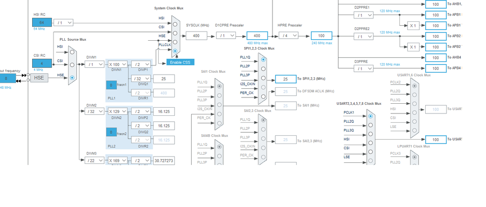

> And both have same freuncy 25MHZ
The slave clock speed should be 2x of the master. Probably not the issue here though.

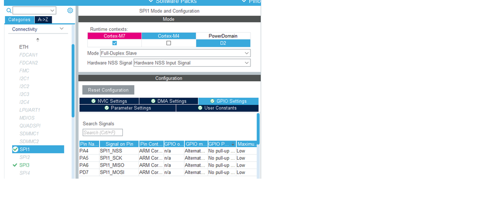

waclawek.jan
> SPI1 as full duplex slave
> And NSS pin of spi1 as output low
You don't control the peripheral's (SPI's) pins direction, the peripheral does that. And NSS for slave is input. You have to pull it down externally.
PS. In the initial post, you've said SPI1 is master. Moving target is harder to hit.

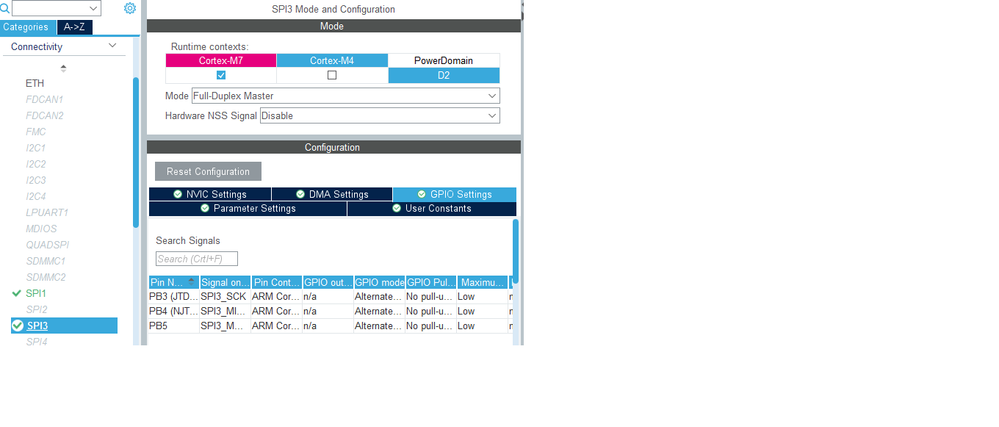

Here is my configuration and code
 MX_GPIO_Init();
 MX_SPI1_Init();
 MX_SPI3_Init();
 MX_USART3_UART_Init();
 /* USER CODE BEGIN 2 */
 HAL_GPIO_WritePin(GPIOA, GPIO_PIN_4, GPIO_PIN_RESET);
 HAL_SPI_Transmit(&hspi3, Tx_SPI4to1, 2, 10);
 HAL_SPI_Receive(&hspi3, Rx_SPI4to1, 2, 10);
 HAL_SPI_Transmit(&hspi1, Tx_SPI1to4, 2, 10);
 HAL_SPI_Receive(&hspi1, Rx_SPI1to4, 2, 10);
 HAL_GPIO_WritePin(GPIOA, GPIO_PIN_4, GPIO_PIN_SET);
this my code .I make the connection SPI1 MISO to SPI3 MISo and SPI1 TO spi3 mosi AND CLK TO CLK BUT UNABLE TO RECEIVE DATA.Can you help resolving this issu.0693W00000BbKMyQAN.png0693W00000BbKMjQAN.png0693W00000BbKNDQA3.pngHere is configuration.That i done.Where I make mistake.
waclawek.jan
Observe the signals using logic analyzer or oscilloscope. Read out and check registers content.
NSS is an important signal for slave.
HAL_SPI_Transmit and HAL_SPI_Receive are blocking functions. You slave needs to be ready to send/receive data before BEFORE the master starts sending a clock. In your code, you're using blocking function for both master and slave, which has no hope of working.
You'll need to use a non-blocking mode DMA for slave or master.
I'm also assuming you meant to say SPI3 rather than SPI4.
