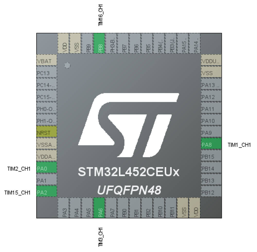

Does this: STM32L452CEU3 provide 4 individual PWM signals?? I am not sure I understand the datasheet on this point.
KMent.1
You can have 5 independent PWM signals on that chip. Each timer output pin can be PWM, but channels within the same timer must have the same frequency.
