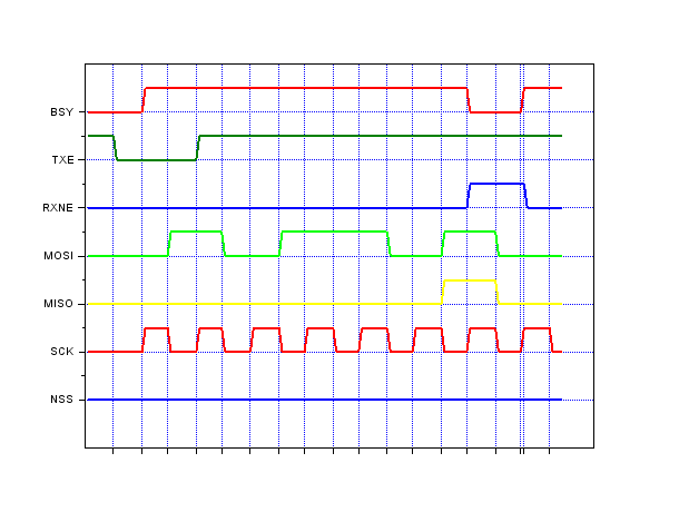

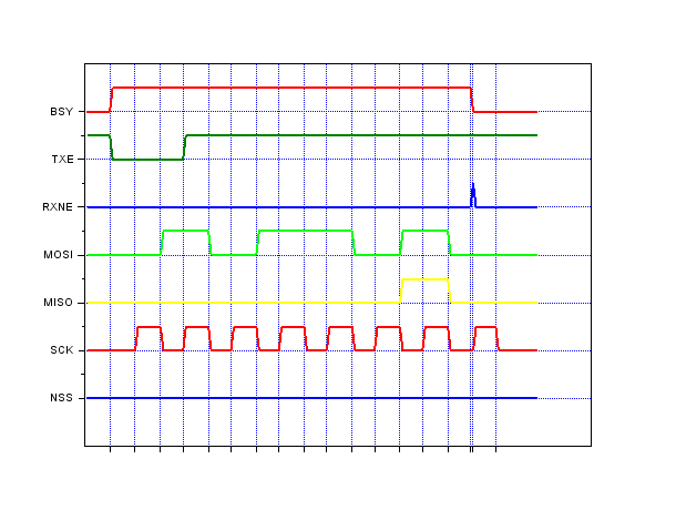

‎2020-11-03 8:36 AM
- In the model example above, the master (SPI1 here) sends 0x5A, the slave (SPI2) has to send 0x03. But really the slave sends 0x02 and receives 0x5B instead of 0x5A. It refers to the mode with CPOL=0, CPHA=0 (or CPOL=1, CPHA=1). There are no problems if CPOL=0, CPHA=1.
- The oscilloscope shows ideal edges. The logical state of the pins and flags of the SPI2 during transmission:
- There is no OSPEEDR in STM32F100xx. There is GPIOx->CRL, GPIOx->CRH (bits CNF, MODE). The maximum speed of GPIO is used in the example.

Very nice diagram. Care to tell us how did yo produce it?
The upper 3 signals, they are from master or slave? Can you try to produce the same for the other SPI?
Is there any other hardware connected, or are the lines only plainly looped back to themselves?

‎2020-11-03 10:58 AM
This is my logic self analyzer technique. The DMA, on a timer signal, reads SPIx->SR and the state of the pins (GPIOx->IR) and stores it in a memory buffer. Then we transfer the accumulated data to a PC for processing.
Those are from slave. It is for master:> Is there any other hardware connected, or are the lines only plainly looped back to themselves?
