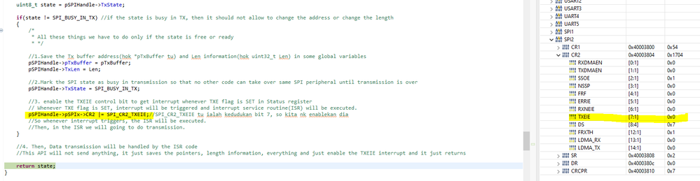

The problem is, in the SPI_SendData() function at the line
pSPIHandle->pSPIx->CR2 |= ( 1 << SPI_CR2_TXEIE );
where the pSPIHandle did not shift the register of CR2 inside the pSPIx address which is SPI2. In this case, I want to SET the TXEIE, but this line did not SET it.

I did try again, here is the screenshot of my IDE during debug Mode.
0693W00000BctA1QAJ.pngthe TXEIE is not SET
> Is there any logic that you see?
Hard to debug through a keyhole. I can't see anything obviously wrong, although redefining CMSIS defines with different values seems like a bad idea.
Like I said above, ensure the clock is enabled. Ensure pSPIHandle->pSPIx points to SPI2 like you think it does. Ensure registers are defined as volatile.
The compiler or hardware is unlikely to be the issue here. Post a minimal working example which exhibits the problem and can be compiled.
If you want to create a driver from scratch, of course feel free, but it's not something I have too much interest in debugging. I had mistakenly thought you were using standard definitions based on your other post.
With your redefined value for SPI_CR2_TXEIE, (1 << SPI_CR2_TXEIE) is the correct value to use here.
