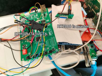

Here are the logs and waveforms. The slave device of IIC is unable to raise the SCL response. The data cannot be sent out either. The code is provided in the attachment.

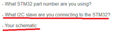

Hello @AngusHZ and welcome to the ST community,
As technical admin in this community, let me ask you to provide more details about your project:
- What STM32 part number are you using?
- What I2C slave are you connecting to the STM32?
- Your schematic
Please read How to write your question to maximize your chances to find a solution
STM32H743VIT6 is slave,I'm use STM32H743VIT6
You still didn't provide all the needed information:
For the second question what is the master?
The master is another device.
STM32 is slave.
In the first question, the attachment contains the code.
Pull-up resistors are essential for the functionality of the I2C bus.
And more specifically, pull-ups in the range of 1k...5kOhm.
This is why @mƎALLEm asked for a schematic.
Second, I2C means "Inter-Ic-Bus", and was designed by Phillips for relatively short connections between components on a single PCB. The long flying wires in the picture will most probably create problems on the physical / signal layer.
Those would be visible on an oscilloscope, but not a logic analyser.
