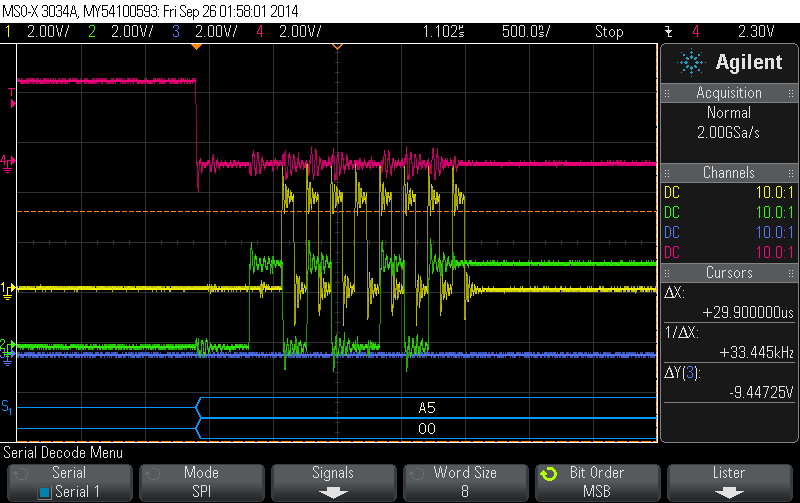

I am seeing some strange behavior in my SPI port.
I expect that it will be set up as CPOL = 0, CPHA = 0 and for the bus to output 0xA5.
What I see is that not only is MOSI transitioning on the wrong edges, but the data appears shifted.
I have inserted my code and a scope capture of the output. Red is CS, Yellow is CLK, and Green is MOSI.
Any ideas as to what is going on here?

I must admit this trace bugs me, software looks good, and this shift shall not happen.
Is this possible for you to post a single file that compiles and produces the error for us to reproduce.
Also tell us which device you are using, and a few words about your HW target.
Last, do not configure GPIO for 50MHz where 25 MHz is good enough, this will reduce the overshoot on electrical signals.

At first I thought that the CPHA signal was incorrect, but on closer inspection, it really looks like the data is shifted backwards in time by a half clock cycle. I am not sure how this is possible.

I just tested this code on an independent hardware target and I am getting the same result.

I found the problem, my scope had almost exactly a half clock cycle skew on the probe input for the clock. I am not sure how it ended up being so close, but I found it when I started varying the SPI baud rate and found that MOSI did not appear to be edge triggered....
A little embarrassing, but sometimes it is the measurement hardware and not the code.
