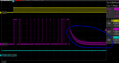

The glitching I'm seeing is more due to my current setup.  This is definitely something I will fix, but that requires making a custom PCB.  I'm trying to eliminate as many fundamental issues (like that callback not being triggered) as I can before committing to a custom PCB.
Example: 1MHz clock and the MISO line showing a good deal of overshoot along with some other noise sources coupling onto the measurement.

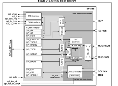

look at the block diagram of this spi :
what will it do, giving constant clk as slave ..? nobody knows.

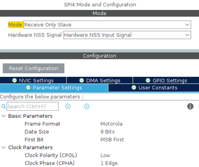

I thought that either an SPI or USART peripheral would be the way to go, with the SPI being a little more malleable.  I was hoping the SPI would reject the clocks if there wasn't any valid data in the buffer to send.  Similarly, with the ability to SW control the NSS even in slave-mode, that seemed promising.
The SPI does seem to work with getting the data out (See prior post), but I am surprised that the callback falls apart.  I expected some timing variability, but not a situation where it never gets called.
The design I thought of to counteract the clocks was to have a flip-flop on the clock net, so that I could enable/disable, but also perform a divide-by-2 if needed.
I will try running it in the proper SPI way, and see if some of these issues go away.

actually you have to first resolve the MISO signal waveform after the last bit of data :
You should not have this kind of signal.
Having continuous CLK is not an issue if you are able to manage correctly NSS pin to select/unselect your slave device. If your master do not controlled correctly the NSS signal (chip select) then you will face some trouble.
