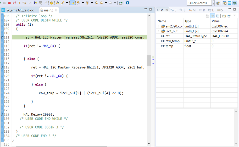

So I've been trying for a while to get the I2C1 peripheral working for communicating with the AM2320 humidity/temperature sensor but for some reasons I have not yet broken down, it never seems to reach it. I used CubeMX to initialize the peripherals and the main.c code is as it follows:

The idea of the code in the while(1) loop is simply to scan for determining what is the address of the AM2320 (which is, according to the datasheet, 0xB8). This is a code that I found thanks to this video: https://www.youtube.com/watch?v=1COFk1M2tak
Unfortunately, it never stops at the line of code where I ask the uC to turn the on-board LED on (where I also put a breakpoint). Digging further while debugging, I noticed that it always hangs at this specific part (also happens when I tried the Master_Transmit command) before timing out.
Electrically, I have my pins connected correctly, SCL1 and SDA1 pulled up to 3,3V (and the AM2320 is powered with 3,3V) with 4,7k resistors. I wonder if this could be a HAL library issue or in the worst case, my uC that has been damaged.
For good measure, I tested the AM2320 with an Arduino Uno and I can read it with no problem, so the sensor is fine. Now I tried using the Arduino IDE to code the Blue Pill and did minor modifications (Mostly for serial port. I2C library commands are the same) and I got about the same results as with STM32CubeIDE: no response from the AM2320.
I know this issue has been reported all over the forums, but I wonder if these could be good hints for the issue.
[Edit 2020-08-24] I tried with the other I2C perihperal (I2C2) and communication still seems to not work. I am wondering if I'm better off directly using the internal registers to be able to communicate with the sensor.

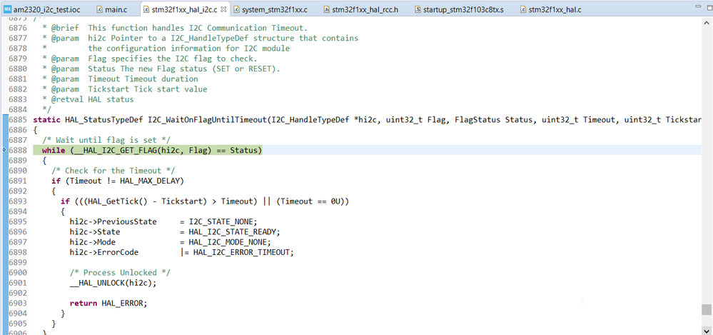

it still failed to transfer anything but it hung up at the line
while(!(I2C1->SR1 & I2C_SR1_SB));
This leads me to believe there might be a problem during the initialization, which I haven't tried doing using low-level code. This will be my next stop.

[Edit] It seems like when writing a 1 to the START bit in the CR1 register, it remains at 1 after exiting an I2C function. According to the datasheet, this bit should be automatically reset after a start condition has been generated, so it seems like it fails to generate the start condition.
