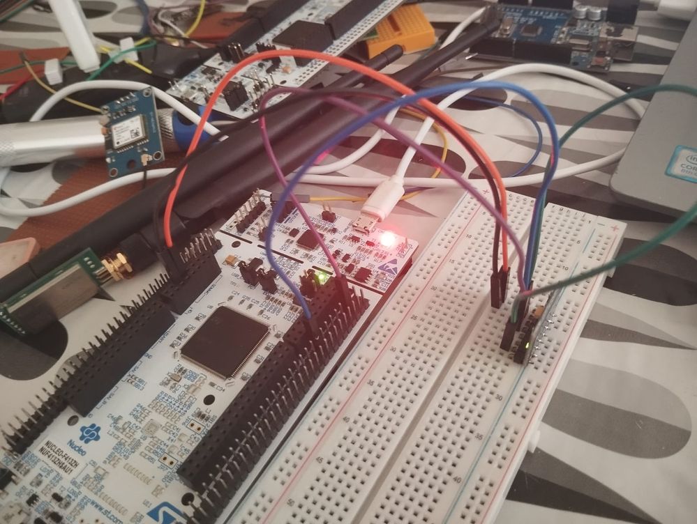

Andrew Neil
You can't fix a hardware problem in software.
If your unreliability problem is due to unreliable connections - which is quite likely with breadboards & long flying leads - there's not a lot you can do about that in software!
Your hardware needs to be reliable for the software to work on it reliably.
This is why I keep asking you to  observe what's happening on the I2C lines - with an oscilloscope !

Did you ever observe what's happening on the I2C lines - with an oscilloscope ?
As @TDK said in that thread, the HAL_BUSY return likely means that one/both line(s) is being held low - you would be able to see that on an oscilloscope.

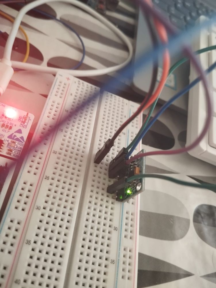

I can't see that you ever confirmed what board you're using - was @Dazai correct in assuming NUCLEO-F413ZH ?
How is your I2C slave connected to the board? long trailing wires? breadboard? other??
Some good, clear photos of your setup would help.

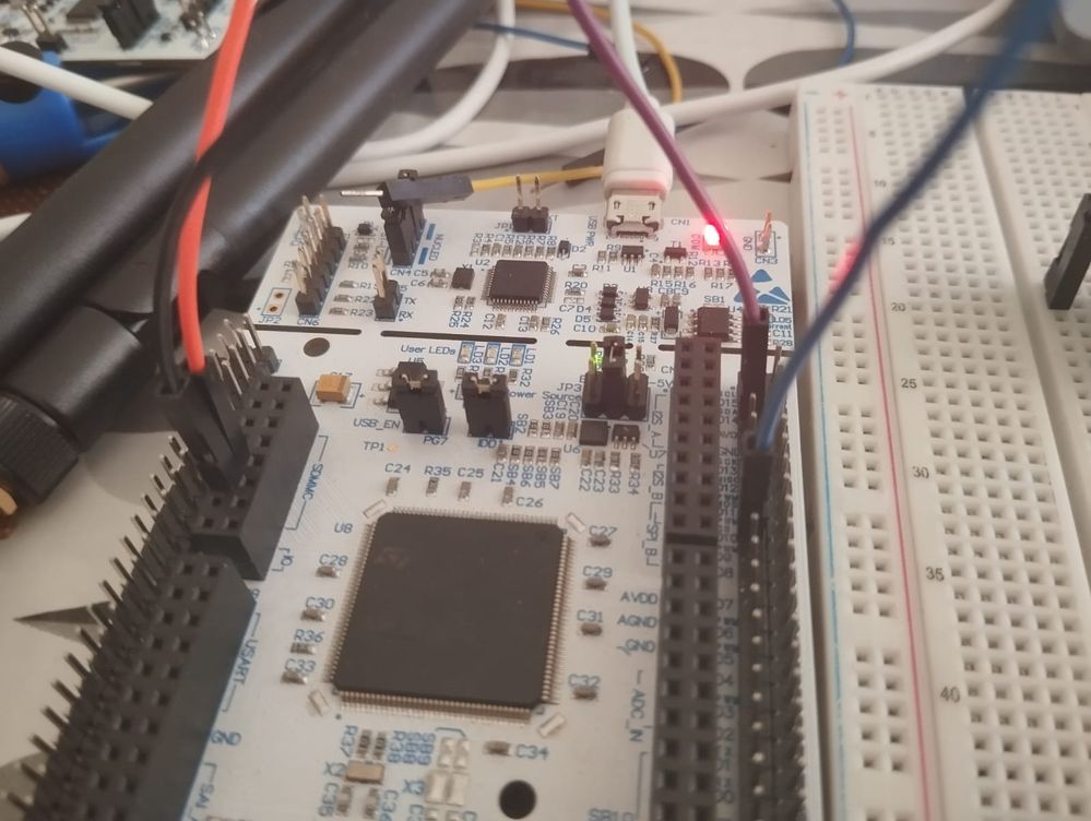

Hi Andrew, first of all, thank you. Yes, the problem continued, but I think I have solved the problem now. I am leaving the code below that I left above. When I added this code, everything got better. Probably the reason for the error was that, as you said, the scl and sda lines did not start as they should. I will leave the code and picture below and the card I use is stm32f413zh.

Yes, I observed the lines and as I mentioned, scl and sda pins are not set correctly in start and spot condition. For this I added this function:
And when I delete this function it usually doesn't work but if it is added it always works.
