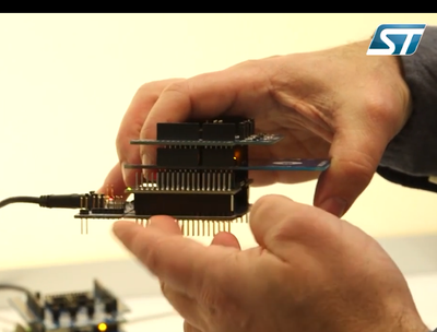

in the video of "Prototype and develop more quickly with STM32 ODE", in minute 1:28 he present the concept of creating an application by stacking different component to demonstart customer project, then he mentioned the most important part that all these components can be moved to a samll form factor board in minute 1:47, where is small board enable customer to do form factor and field test.

Googling "Prototype and develop more quickly with STM32 ODE" finds a few - this seems to match the stills you posted:

Here's a longer video on the ODE:
https://www.youtube.com/watch?v=cwmTiBchPFI
"Compact Solution Boards" @ 2:34:
https://youtu.be/cwmTiBchPFI?t=154
and it gives the link:
https://st.com/STM32ODE
