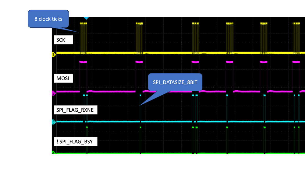

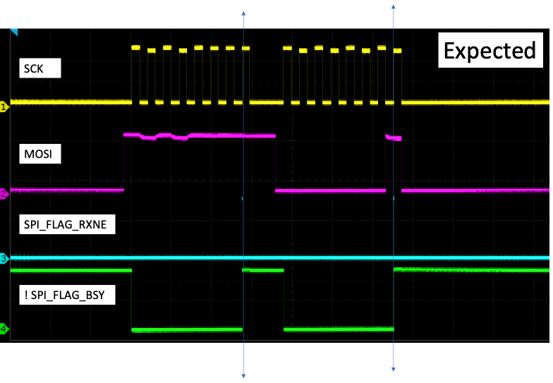

In these plots CH3 is connected to a gpio that tracks SPI_FLAG_RXNE, while CH4 is connected to !SPI_FLAG_BSY .
What I expect to see is SPI_FLAG_RXNE firing with the rising edge of SCK on the reception of the 8th bit like this:

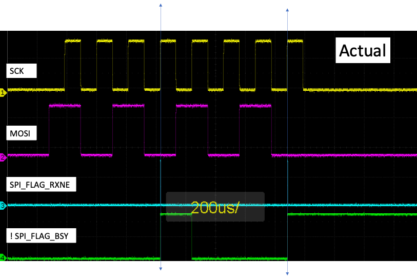

 However with this SPI driver the SPI_FLAG_RXNE signal seems to look like this:
Result is wrong data received.  This happens independent of SCK speed.  Validated the STM32 slave inputs using a simple bitbang SPI slave, and data is received with no errors.

Looks like the master and slave are out of sync. The CS pin is typically used to ensure byte-alignment between the interfaces. It doesn't look like you're using a CS pin.
While the above may also be relevant, looks like it's accepting a byte after 4 bits, and not 8. I wonder if there's some bouncing on the SCK line that would be causing duplicate bits. That would be quite odd, but I don't see what else it could be. Maybe try using slower GPIO speeds.

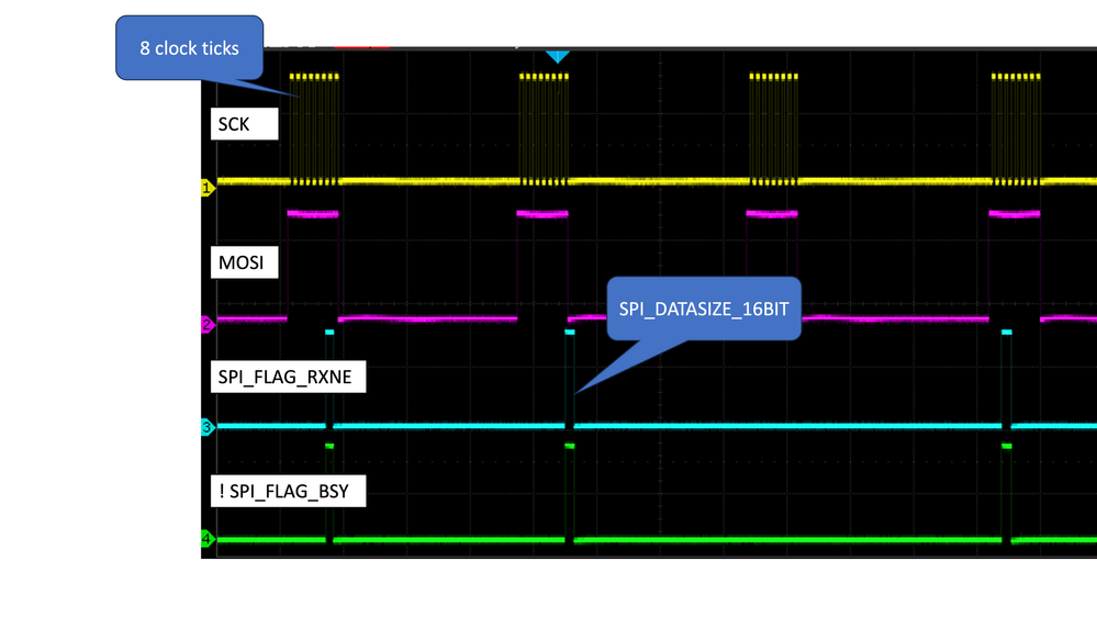

Increasing word size does have an impact, but the clock counter on slave still seems to be off...

I believe TDK is right and this is consequence of SCK bounce; maybe inadequate ground/return.
Decreasing bitrate won't help, this is all about the SCK edges.

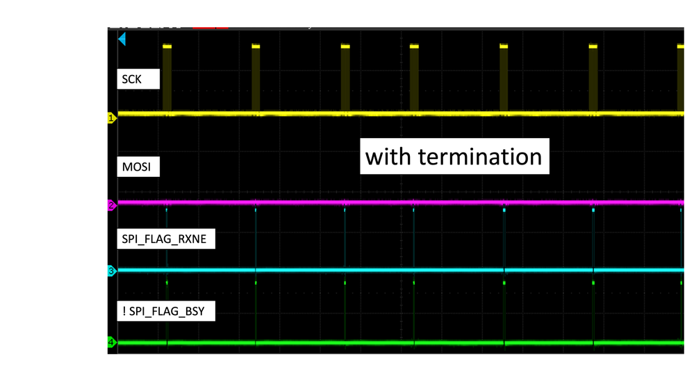

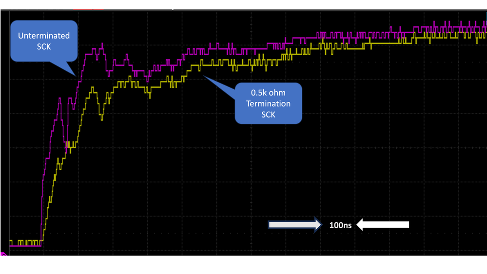

Terminating the SCK on slave stm side seems to help a LOT:
after adding a terminating resistor on sink of SCK:
much better--thanks TDK and waclawek.jan .
However the performance is still pretty poor--starts having errors around 200kHz .  The Slave SPI receiver must use analog logic to process SCK for this termination to make such a difference. Perhaps the termination scheme needs to be further optimized--over the exact same cable and setup the following bitbang version of SPI slave gets to around 1.2MHz :

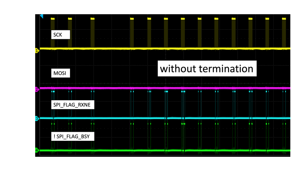

with and without termination signals look like this on slow clocks:
around 200KHz there are single bit flip errors in about 10% of the data: if hardware slave select is enabled in receiver then the bit flip errors are the last bit.  otherwise they're the first bit.  at around 250KHz and above errors are equally distributed across bits. grounds are shared and no microwave, however a powerful subwoofer under the unit :)
