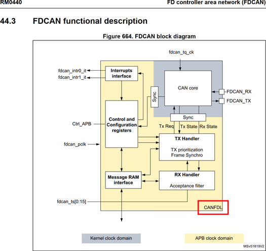

I am developing some applications that use an STM32G431 MCU and have a question about one of the figures in the reference manual (RM0440). In the chapter descripting the FDCAN peripheral, Figure 664 "FDCAN block diagram" (MSv51819V2) labels the FDCAN peripheral block as "FDCANL". What is the significance of the "L" suffix here? Is it a revision code of some sort? Does it indicate a "light" version of the peripheral? Something else?
For comparison, I looked at some other reference manuals:

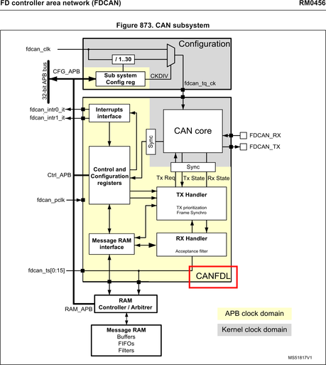

  • RM0456 (STM32U5 series) shows "CANFDL" as well (Figure 873, MS51817V1)

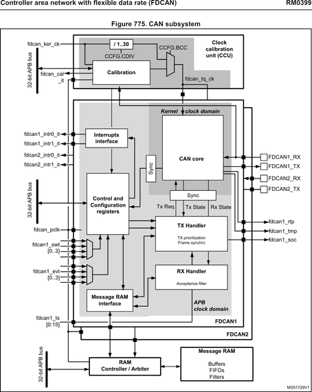

  • RM0399 (for STM32H757) shows "FDCAN1" and "FDCAN2" (since there are two instances on that device) (Figure 775, MS51729V1).

Just received the answer regarding this subject and "L" suffix refers to Light version as it has less features versus the one implemented in STM32H757.
