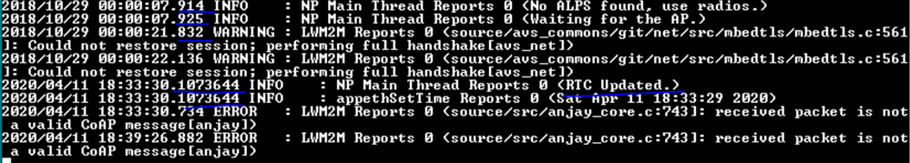

@Community member​ But after resolving above issue I am putting right values (for test earlier i was using fixed value) calculated for SUBFS using following code that does not seem right in terms of output i get for sub-seconds. My variable parameter passed to this function is in microsecond and then i apply calculations(are they right?)to convert it to value to be inserted into SUBFS for both scenarios advance and delay.
It shows a very large number when i print in sub second value read straight after executing SynchSubSecond() function.
while, i am printing only milliseconds converted from subsecond register value. i will attach below the actual output on tera term for value read. code is as follows:

Terminal output for time read from RTC. last part of time after . is milliseconds using RTC sub sec register value
if you notice in image above as soon as i called that function to update RTC and its subsecond. rest is ok but sub second which i am printing in millisecond becomes a very large value which after a sec changes to normal value again that is 3 digit millisecond. Any idea what can cause such a large value in sub-second.

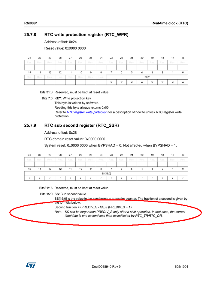

I don't use the subsecond counter but it perhaps might be consequence of this:
That is exactly the case based on my observations. After adjusting the clock based on if SSR greater than PREDIV_S it is giving me right values now. Thanks very much for your help.
