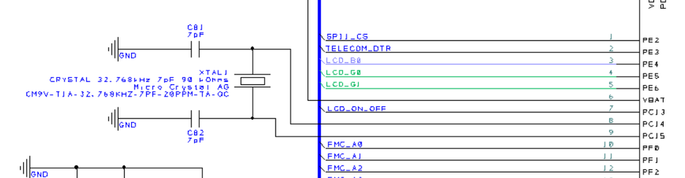

Hardware 1: STM32F767ZGT6 with LSE Crystal Model:  CM9V-T1A-32.768KHZ-7PF-20PPM-TA-QC Maker: Micro Crystal AG
Hardware 2: STM32F767IIT6 with LSE Crystal  Model: ECS-.327-12.5-12R-C-TR Maker: ECS Inc
Compiler: IAR Workbench v8.32.1
Driver: STM32Cube_FW_F7_V1.15.0
Hi.
I have two PCB designs with the above different MCU and LSE crystals chosen from AN4759. However, HAL_RTC_Init(…) usually fails and when it does work the RTC clock is very inaccurate. Can someone please advise what I am doing wrong in by code?

waclawek.jan
Layout of the LSE circuitry matters. Review and/or post it.
Try your code on a known-good board such as Nucleo or Disco.
Experiment with the LSE drive level, see RCC_BDCR.LSEDRV.
Read AN2867.
I did a quick calculation of your crystals after AN2867, as mentioned by @Community member​ - for both of them the default drive level (low) is not sufficient and must be set at least to medium low or even medium high.
It looks like you are working with HAL, so you can very easily insert a macro to set LSEDRV in the initialization of HAL_RTC_MspInit() right after the clock selection (because LSE is located in the backup domain and write access to this domain is denied after reset). The macro is defined in stm32f7xx_hal_rcc.h:
/* Configures the External Low Speed oscillator (LSE) drive capability */
__HAL_RCC_LSEDRIVE_CONFIG(RCC_LSEDRIVE_MEDIUMHIGH);
Good luck!
Regards
/Peter
Andrew Hazelton
Hi.
Thank you for your time. I found that I forgot to enable the LSE with the HAL_RCC_OscConfig(&RCC_OscInitStruct) function. The code should have been as per the below:
/* Enable HSE Oscillator and activate PLL with HSE as source */
    RCC_OscInitStruct.OscillatorType      = RCC_OSCILLATORTYPE_HSE | RCC_OSCILLATORTYPE_LSI | RCC_OSCILLATORTYPE_LSE;
    RCC_OscInitStruct.HSEState            = RCC_HSE_BYPASS;
    RCC_OscInitStruct.LSEState            = RCC_LSE_ON;
    RCC_OscInitStruct.HSIState            = RCC_HSI_OFF;
    RCC_OscInitStruct.LSIState            = RCC_LSI_OFF;
    RCC_OscInitStruct.PLL.PLLState        = RCC_PLL_ON;
    RCC_OscInitStruct.PLL.PLLSource       = RCC_PLLSOURCE_HSE;
    RCC_OscInitStruct.PLL.PLLM            = 24;
    RCC_OscInitStruct.PLL.PLLN            = 400;
    RCC_OscInitStruct.PLL.PLLP            = RCC_PLLP_DIV2;
    RCC_OscInitStruct.PLL.PLLQ            = 8;
    RCC_OscInitStruct.PLL.PLLR            = 2;
    ret = HAL_RCC_OscConfig(&RCC_OscInitStruct);
I have also included the LSEDRIVE function that appear to be working well.
