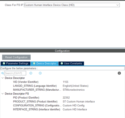

      • I2C1->i2c, change to i2c speed mode from standard mode to fast mode
      • USB_OTG_FS-> mode: Device_Only
    • Middleware and software
      • Class for FS IP: select Custom Human Interface Device and change the PID to 22352

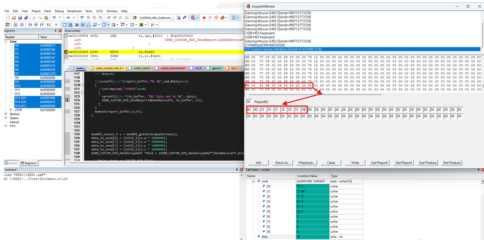

Result:
  1. BNO055 pin connection: SCL-> PB8, SDA->PB9, 3V0->VCC, GND->GND, ADR->GND
  2. Option for Target "myHIDBNO055", in the device->code generation, select "Use MicroLIB"
  3. Connect the USB power from CN1(micro A) first, and connect the User USB from CN13
  4. The HID device could found from host
  5. Could read the BNO055 via I2C
  6. Could send the data from STM32 to host in100Hz
  7. Could receive the data from host to STM32 first time
  8. Fail: Could not receive the data from host to STM32 second time
    1. modify the BNO055 speed by HAL_Delay(10 ~ 1000), the tool still crash

steve feng
Hi
After some testing,
The problem is from function "USBD_CUSTOM_HID_DataOut()"
static uint8_t USBD_CUSTOM_HID_DataOut(...)
    // ... callback after
    return (uint8_t)USBD_OK;
    // did not called, USBD_CUSTOM_HID_ReceivePacket()!
    // OUT endpoint will not preprare to receive the new data
    // the second data send from host, stm will lock in NAK
    // SimpleHIDWrite timeout ->software crash
I found the problem that I forget to add this
static uint8_t USBD_CUSTOM_HID_DataOut(USBD_HandleTypeDef *pdev, uint8_t epnum)
    UNUSED(epnum);
    USBD_CUSTOM_HID_HandleTypeDef *hhid;
    if (pdev->pClassDataCmsit[pdev->classId] == NULL)
        return (uint8_t)USBD_FAIL;
    hhid = (USBD_CUSTOM_HID_HandleTypeDef *)pdev->pClassDataCmsit[pdev->classId];
#ifdef USBD_CUSTOMHID_REPORT_BUFFER_EVENT_ENABLED
    ((USBD_CUSTOM_HID_ItfTypeDef *)pdev->pUserData[pdev->classId])->OutEvent(hhid->Report_buf);
#else
    ((USBD_CUSTOM_HID_ItfTypeDef *)pdev->pUserData[pdev->classId])->OutEvent(hhid->Report_buf[0],
                                                                             hhid->Report_buf[1]);
#endif
    /* add this line */
    (void)USBD_CUSTOM_HID_ReceivePacket(pdev);
1.This file is not in user code part (this is STM32 HAL middleware), if CUBEMX re-generate, these  code will be          overwritten.
2.After this step, I can receive and transmit the data from BNO055 to STM32 and get these data via USB HID.
the main part
