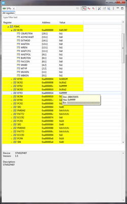

Please find attached a register dump of the FSMC as setup for my project.
Hope this helps.
Regards, Toneski.

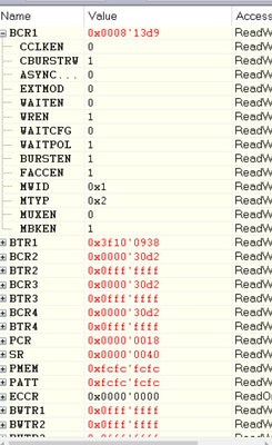

Toneski
...Another copy, but with BCR1 expanded.
