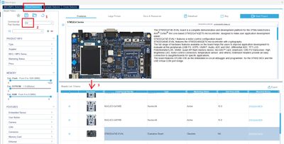

Hello @Pulkeshi and welcome to the community,
The more easiest way to find an eval board for a specific product is to use STM32CubeMx:
1- Go to Board Selector tab
2- Type the family name: in your case "G4"
3- Go to the list appeared at the bottom that shows all the available boards for that family.

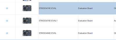

In your case only these eval board are available:
Unfortunately not for G491. Also there is no Ethernet interface for G4 family. You need to add an external bridge SPI/Ethernet or UART/Ethernet

mƎALLEm
