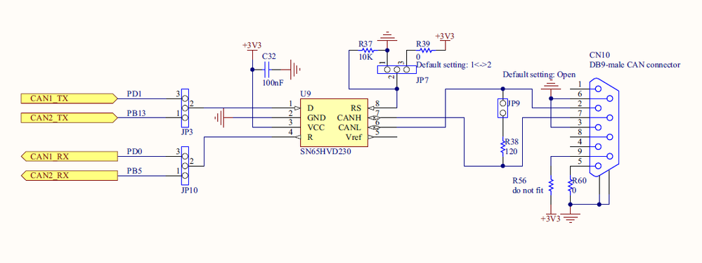

STM3240G-EVAL and STM3241G-EVAL boards have two CAN interfaces (but only one transceiver).
All CAN signals are available on external headers however:

That would work exactly the same way as if I had two transceivers, right ?
For you to understant a bit more, I am trying to basically create a link between two CAN network working at a different rate. These boards could work for this application, right ?

Posted on June 12, 2018 at 14:44
EVAL boards are pretty expensive but the only ones that have onboard transceiver and DB9 connector.
As a much cheaper alternative you may want to go with a
http://www.st.com/content/st_com/en/products/evaluation-tools/product-evaluation-tools/mcu-eval-tools/stm32-mcu-eval-tools/stm32-mcu-nucleo/nucleo-f446re.html
 and mount external transceivers such as
https://www.amazon.com/SN65HVD230-CAN-Board-Communication-Development/dp/B00KM6XMXO/ref=sr_1_2?ie=UTF8&qid=1528806936&sr=8-2&keywords=SN65HVD230
 (just picked up the first Amazon choice, double check if suits your needs).

Posted on June 12, 2018 at 16:10
Just to be sure I won't make any mistake, if I chose the Nucleo board, I would need to buy 2 transceivers, right (or find one that could take 2 inputs, 2 outputs and send them on 2 different CAN bus) ?
Yes, that's correct. One transceiver per CAN interface.
