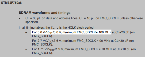

Hello, with a STM32F7508-DK board, all examples using SDRAM have the sysclk to 200MHz, therefore the FMC clock to 100MHz.
I am trying to enable sysclk = 216MHz, and FMC = 108MHz, so I followed the SDRAM user manual, and configured the following settings, which seem correct to me:
#define REFRESH_COUNT                   ((uint32_t)0x0684)  /* SDRAM refresh counter (108Mhz SD clock) */
 /* Timing configuration for 108Mhz as SDRAM clock frequency (System clock is up to 216Mhz) */
 Timing.LoadToActiveDelay   = 2;
 Timing.ExitSelfRefreshDelay = 8;
 Timing.SelfRefreshTime     = 5;
 Timing.RowCycleDelay       = 8;
 Timing.WriteRecoveryTime   = 3;
 Timing.RPDelay             = 3;
 Timing.RCDDelay            = 3;
However, even with these timings for the SDRAM (of course I set the PLL for 216MHz sysclk), I have random faults when accessing the SDRAM.

Look for SDRAM waveforms and timings in the datasheet.

Well, that is the point, I did all that and below the computation I did:
  • To support frequencies over 100MHz, I switched to CAS Latency 3 for the SDRAM, also increased the SDRAM GPIOs speed to max (OSPEED HIGH)
  • Then, I analyzed both IS42S32400F-6BL (ISSI) and MT48LC4M32B2B5-6A(MICRON) datasheets, as the STM32F7508-DISCO board seem to have either one. Based on the datasheets, I set:
    • #define REFRESH_COUNT                   ((uint32_t)0x0683) => 15.625 ns (64ms refresh per 4096 rows) * 108MHz - 20
    • Timing.LoadToActiveDelay   = 2; => tMRD = 2 clk cycles (Micron) or 12ns (ISSI)
    •  Timing.ExitSelfRefreshDelay = 8; => tXSR = 67ns (Micron) or 70ns (ISSI)
    •  Timing.SelfRefreshTime     = 5; => tRAS = 42ns (Micron and ISSI)
    •  Timing.RowCycleDelay       = 7; => tRC = 60ns (Micron and ISSI)
    •  Timing.WriteRecoveryTime   = 2; => tWR/tDPL = 1 clk + 7ns (Micron) and 2 clk (ISSI)
    •  Timing.RPDelay             = 2; => tRP = 18ns (Micron and ISSI)
    •  Timing.RCDDelay            = 2; => tRCD = 18ns (Micron and ISSI)
Still, I have a RAM test which is passing but I get random faults with incomprehensible CPU registers content when accessing the SDRAM, so clearly I am missing something.
My point is that if the board supports this as a max frequency, why doesn't STM provide a working configuration?
berendi
Principal
VVasi.1
Many thanks, I missed that. We can consider this topic closed
