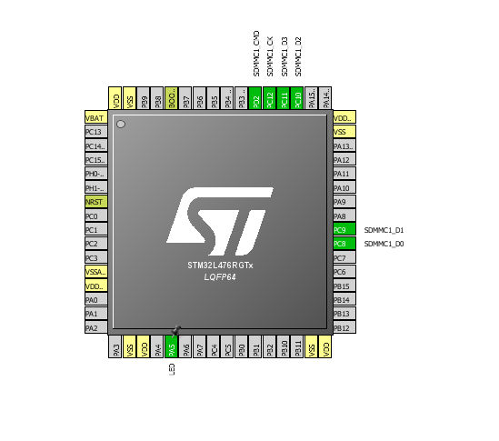

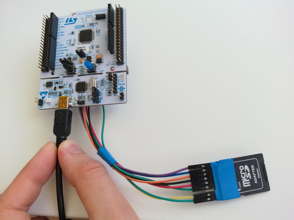

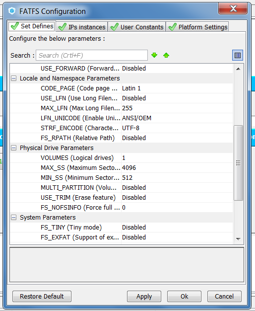

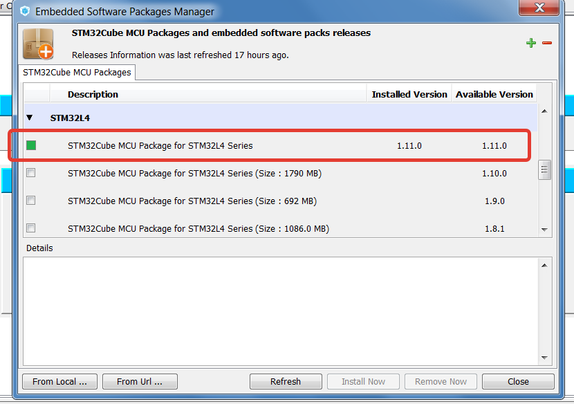

Dear friends,

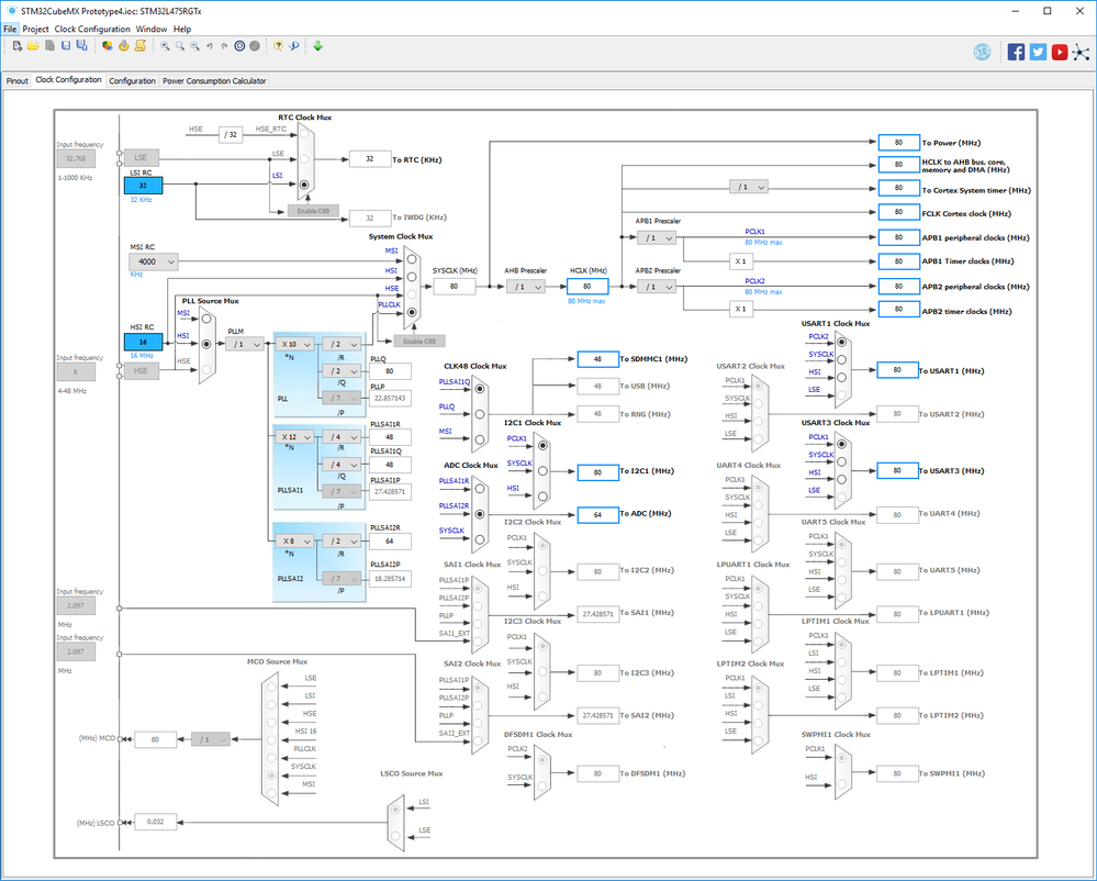

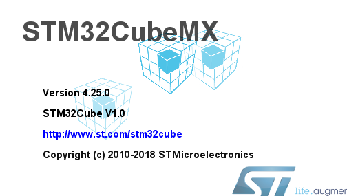

I have an issue with uSD reading and writing in DMA mode (How ever I am able to read and write data on SD card when dma template is off). I used CubeMX to configure♯
but it did not work for me ''out of the box''.My CubeMX version is 4.25.0 and L4 MCU package is 1.11.0.
Could you point out what I am doing wrong in configuration or in my code or if it is CubeMX issue, could you please advice me how to solve it?
I found some topics related to SDIO and DMA configuration and tried to implement them :https://community.st.com/0D50X00009XkVtKSAV
?https://community.st.com/0D50X00009Xkf5gSAB
?https://community.st.com/0D50X00009XkYIGSA3
?Below you find screen shots with my settings and my SW4STM32 project including CubeMX file.
My MCU setup:
My CubeMX configuration:
1) Clock
2)Clock factor
3)NVIC
4)DMA
5)Pin configuration
6)FatFS (sector size)
7)DMA template enabled
#fatfs-sdio #stm32l476 #sdio-dma #sd-card #sdio+dma+fatfs #stm32l4-sdioSolved! Go to Solution.

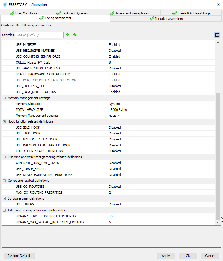

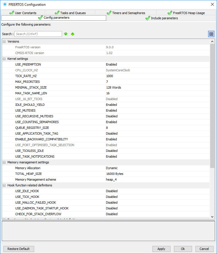

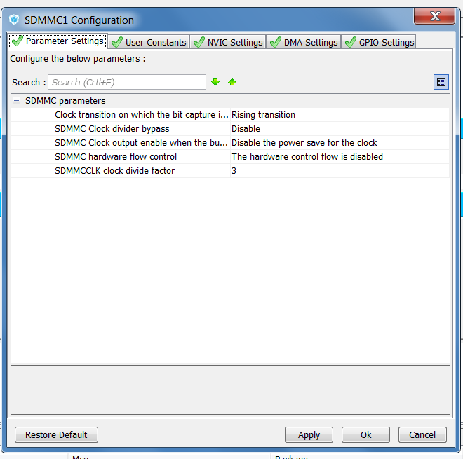

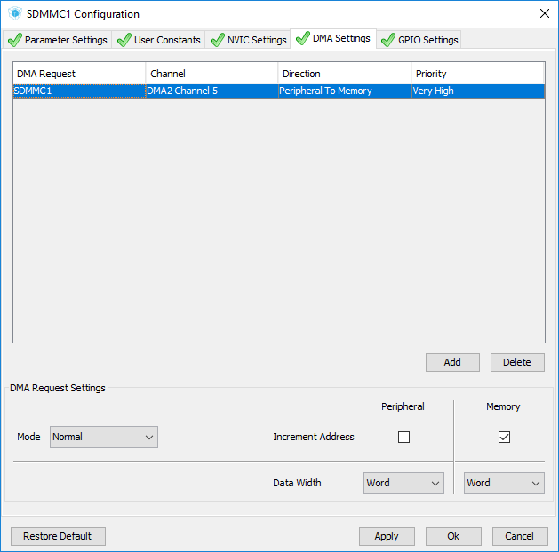

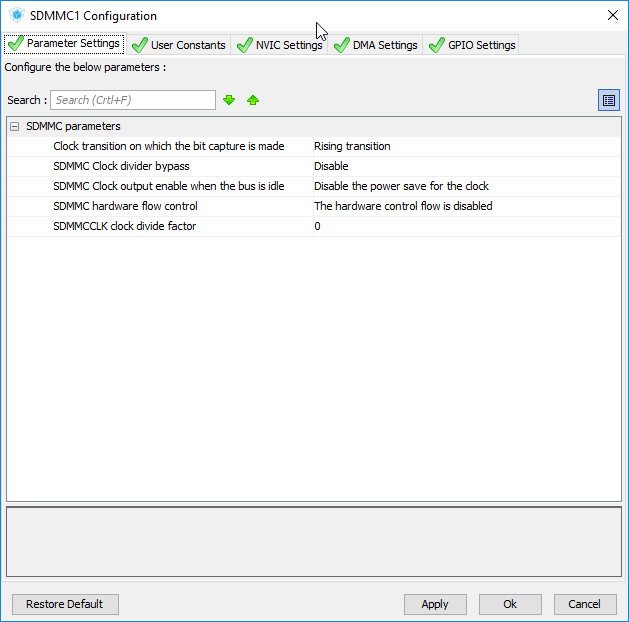

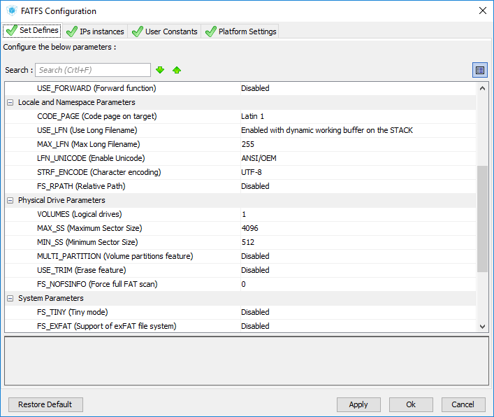

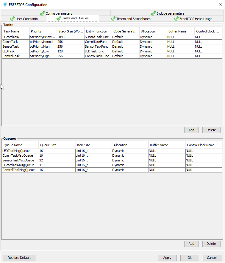

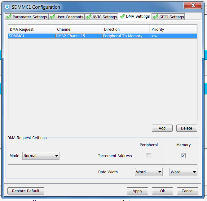

2018-05-01 07:48 AM
Hi Dmitry,
What exactly is not working?
Are you using RTOS? I have my code running on top of the FREERTOS, generated by CubeMX (same project).
I do not have a separate demo-project, but I can share the files I modified (attached). The fatfs.c is modified to use RTC time for files.
My initialization procedure is as follows:
SD_Initialize(); if(BSP_SD_IsDetected()) { if(f_mount(&SDFatFs, (TCHAR const*)SDPath, 0) == FR_OK) { sd_mounted = 1; } }�?�?�?�?�?�?�?�?�?�?�?�?�?�?�?�?�?�?�?�?�?�?
Where:
static void SD_Initialize(void) { if (isInitialized == 0) { BSP_SD_Init(); BSP_SD_ITConfig(); if(BSP_SD_IsDetected()) { isInitialized = 1; } } }�?�?�?�?�?�?�?�?�?�?�?�?�?�?�?�?�?�?�?�?�?�?�?�?�?�?

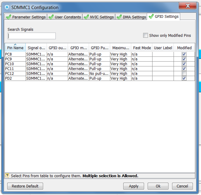

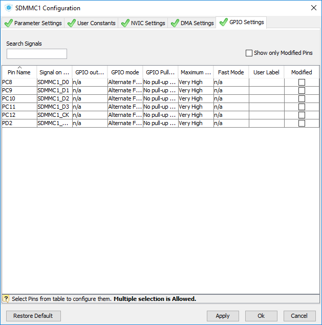

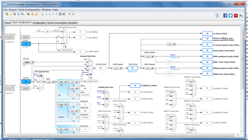

I also attached some screenshots, where I found differences between yours and my project configuration in CubeMX.
As you can see, I have SDMMC1 48MHz clock and SDMMCCCLK clock divider is set to 0. The DMA priority is Very High, but I don't think this should be an issue. Also, I don't use internal pull-ups since I have them externally. Finally, I enabled long filenames support in FatFs.
I hope this helps.

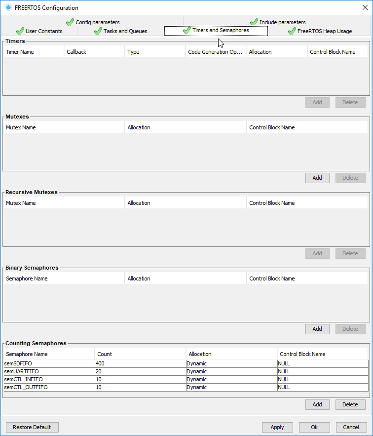

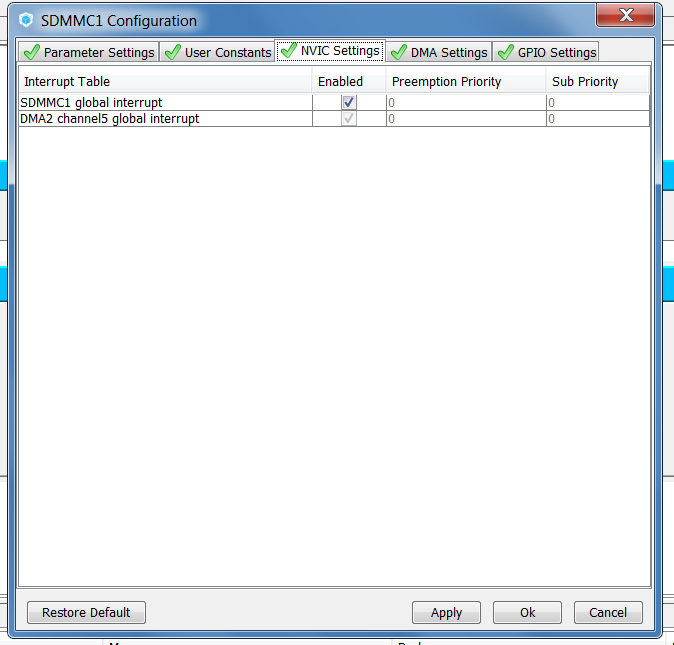

2018-05-02 09:12 AM
Hi Dmitry,

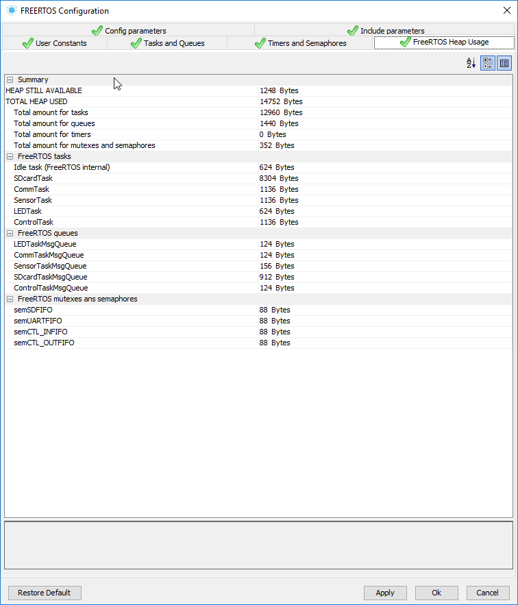

If you set a breakpoint in your task, does it stop there? If not, it might be an issue with task priorities (although, you have only one task?) Also, have a look at heap size.

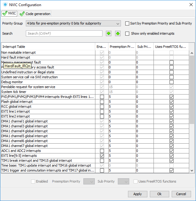

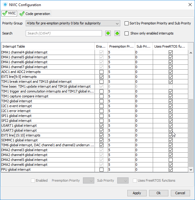

Here are the screenshots of the settings from my project.
2018-05-03 10:24 AM
Dear Evgeny,
Thanks a lot for your support. I did a corrections according to your screen shots.
I found out that freezed program start was caused by error in timer configuration. I changed the input for sd card clock to PLLQ with 40MHz and it partially works now (I am able to blink a led in freertos:)).
Another thing is that my f_mount function with mount later option
f_mount(&SDFatFS, (TCHAR const*)SDPath, 0) returns FR_OK and it is a good sign,
however if I select f_mount(&SDFatFS, (TCHAR const*)SDPath, 1)
it returns FR_DISK_ERR.
Below you could see a code that generates an error:
fmt = check_fs(fs, bsect); /* Load sector 0 and check if it is an FAT-VBR as SFD */
if (fmt == 2 || (fmt < 2 && LD2PT(vol) != 0)) { /* Not an FAT-VBR or forced partition number */ for (i = 0; i < 4; i++) { /* Get partition offset */ pt = fs->win + (MBR_Table + i * SZ_PTE); br[i] = pt[PTE_System] ? ld_dword(pt + PTE_StLba) : 0; } i = LD2PT(vol); /* Partition number: 0:auto, 1-4:forced */ if🙂
i--; do { /* Find an FAT volume */ bsect = br[i]; fmt = bsect ? check_fs(fs, bsect) : 3; /* Check the partition */ } while (LD2PT(vol) == 0 && fmt >= 2 && ++i < 4); } if (fmt == 4) return FR_DISK_ERR; /* An error occured in the disk I/O layer */Today evening I will try to debug it and write you back with my results tomorrow. If you have any suggestions, please write me back. I appreciate your help.
Best regards,
Dmitry.

in the topic I will try it today.2018-05-11 02:20 AM
Finally, I get it worked with CubeMX 4.25 and MCU pack 1.0!
The list of issues:
1) Missing line in time configuration
RCC_OscInitStruct.PLL.PLLM = 1; //Missed line
2) Change according to
Kirshin.Evgeny
3) Change according to
Vasiliev.Alexander
4) I suggest to use short filenames written in lower case letters.
I will update the git repository I mentioned behind.
Thanks a lot to
Kirshin.Evgeny
andVasiliev.Alexander
. You help deserves a beer;)Best regards,
Dmitry.
2018-05-11 09:36 AM
I am glad you solved your problem.
Was the issue only in one line to set the PLLM?
Which toolchain/compiler are you using?
Long file names with capitals work for me (there is a setting in FatFs configuration to enable long file name support).
