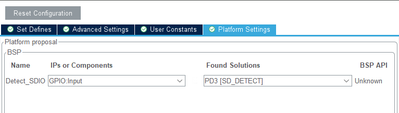

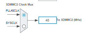

I reduced the speed of the SDcard to 400kHz and mounted it on a nucleo board. Still did not do it on the custom board. I now have the feeling something is not right with the custom board.

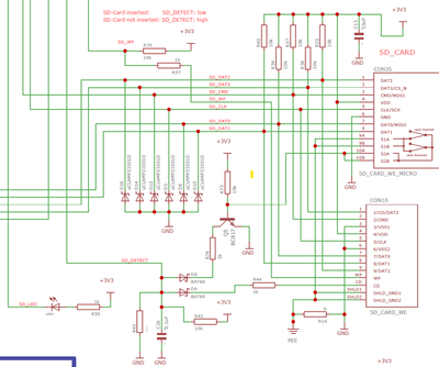

So your hardware is not working .
What board : custom or nucleo ...?
Length of tracks cpu -- sdcard ?

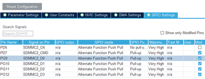

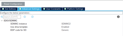

try simple setup for beginning with sd-card:
- 1 bit mode
- no dma template
- port/pins : all on speed: medium + pullup on
Its a custom board
The same problem I am facing after making sure only 1 bit, No DMA and all GPIO pins on medium speed
Still init not working?
Then first check all signals to sd-card with scope . (10:1 low cap. tip)
If ok (3,3V....etc) look at CMD , here first (400kHz speed) "hello card..." communication;
if this ok, it switching to hi-speed (5...25Mbit), if long lines, then here problems begin to show up.
Track length is below 3 inches .

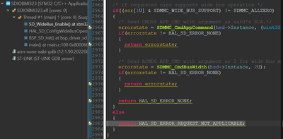

I did order a nucloe board and connected an SD card reader to it where I did see that it was connected in the 1bit mode but it was not connecting in the 4 bit mode.
When I am trying to enable the 4 bit mode then it is returning HAL_SD_ERROR_REQUEST_NOT_APPLICABLE
Clock is 108 MHz but I have put a clock div of 16 which makes 108/CLKDIV+2 which makes it 6 Mhz. Please help where we can look next.
