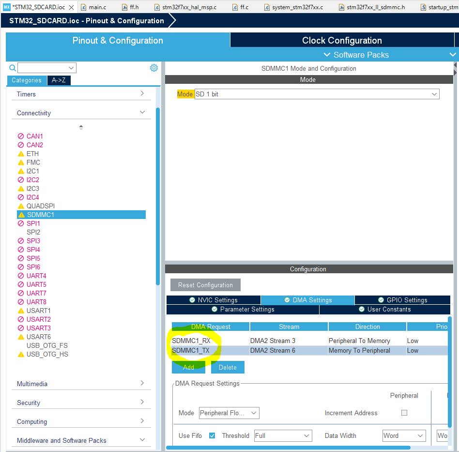

I purchased the STM32F746G-DISCO in the hope of being able to read and write to an SD card.
I followed the guide below...
https://community.st.com/t5/stm32-mcus/how-to-create-a-file-system-on-a-sd-card-using-stm32cubeide/ta-p/49830
However, when stepping through the code I can see it is going to the Error_Handler when the function f_mkfs is called...
if(f_mkfs((TCHAR const*)SDPath, FM_ANY, 0, rtext, sizeof(rtext)) != FR_OK)
    Error_Handler();
I have tried two different SD cards:
1. Kingston 16GB microSDHC CL10
2. Transcend 2 GB MicroSD Micro SD Card, Class 30 (TS2GUSD)
When reading the comments at the bottom of the guide, I noticed that others also had the same issue .
I tried the suggestion made by TKana.1 (i.e. moved variables to global and changed 4B wide operation to 1B operation in MX_SDMMC1_SD_Init) but the error still occurs.
Why does the code in this guide not work and how do I fix it ?

I managed to get it working
I watched the video of the same guide and noticed the video has an extra step to add the DMA request for RX and TX...
Since doing that the code now writes to both SD cards BUT only when the SD mode is 1 bit.
It does not work when the SD mode is 4 bit.
I did try manually changing to 1 bit by setting...
hsd1.Init.BusWide = SDMMC_BUS_WIDE_1B;
But this did not seem to work.
It only started working after I added the DMA requests as shown in the video, but not the written guide.
So the error is the missing step in the guide then ?
I assume SD mode 4 bit wide would be faster than 1 bit ?  In which case, how do I get 4 bit wide mode working ?

ST also keeps changing it's strategy with SDIO/SDMMC, at one time you put the 4-bit mode in the init structure, other times you put it in 1-bit mode, and then call the "WideMode" function later to negotiate a higher speed.
4-Bit mode is far less tolerant of issues with the electrical connectivity, so termination, reflections and signal skewing get to be things as the clock rate increases.
Cards also have zero tolerance of you wandering off-task mid transfer, there is a FIFO, but it's depth is limited. ST's pollled-mode operation is also flawed, it deals with everything as misaligned, which is far from optimal.
DMA is preferred, but that brings it's own issues of coherency. For the F7 using the DTCM for aligned buffers is strongly recommended. The DCache methods also have their own set of issues, most particularly the 32-byte width, and the ability to corrupt abutting structures/data.
:thumbs_up:
About DMA : i had it always without dma (in fatfs : dma template off) , so the dma setting should be not important for working or not. (No dma: because i anyway wait for the data on a read etc , so no sense to make it more complicated.)
SD mode 4 bit wide is faster , but if you dont need maximum speed, why  make it more complicated. :)
But try - it should work now, just set it in Cube. (+ check: its connected 4bit on your board !!!)
+ First set correct speed for sdio: i use 100MHz , and clkdiv 1 in sdio parameter (in Cube) , = 50M for card.
