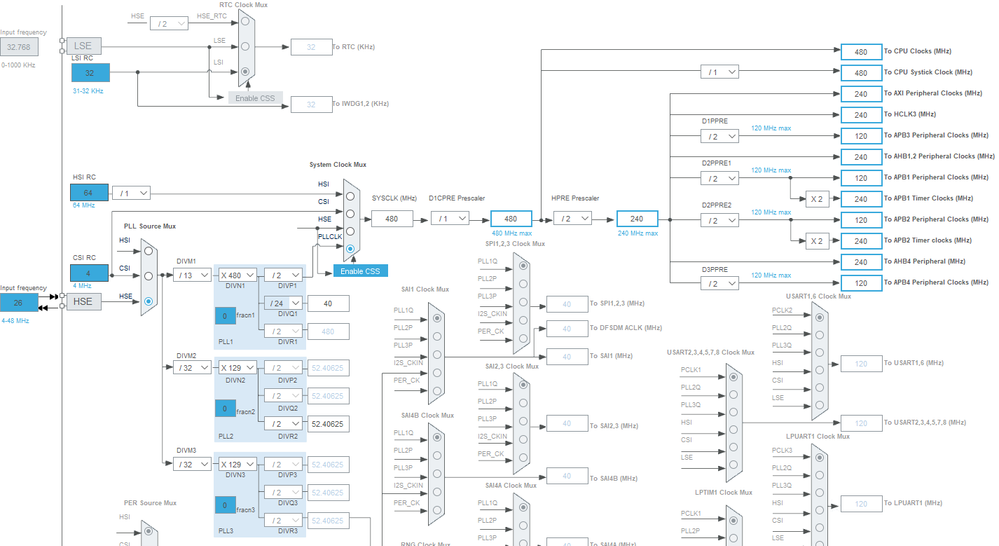

I'm currently facing an issue with a basic project to setup the SDMMC1 peripheral where the function HAL_SD_Init() fails. The issue is happening inside HAL_SD_Init(), in SD_PowerON(), where it always returns HAL_SD_ERROR_UNSUPPORTED_FEATURE.
I'm using a custom board with the STM32H743XI MCU with an external clock of 26MHz and the STM32CubeH7_FW_H7_V1.11.0 package.
Please find below a picture of the STM32CubeMX Clock configuration:
0693W00000Y8g0PQAR.png0693W00000Y8g0jQAB.pngHere is the code that setup the clock:

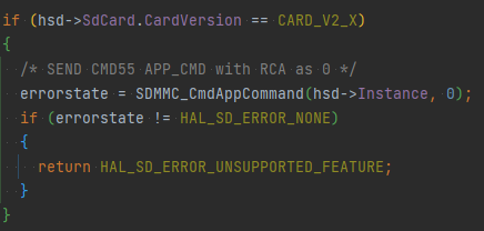

hi,
same issue with maine for controller-STM32H723VGT6.
After a deeply study ,i also found issue with sd card initialization on the level of.....
 if (hsd->SdCard.CardVersion == CARD_V2_X)
  /* SEND CMD55 APP_CMD with RCA as 0 */
  errorstate = SDMMC_CmdAppCommand(hsd->Instance, 0);
  if (errorstate != HAL_SD_ERROR_NONE)
   return HAL_SD_ERROR_UNSUPPORTED_FEATURE;
please share the solution ,how you have been resolved .

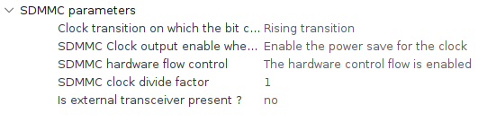

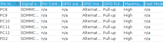

on my H743 board here i use this setting :
0693W00000Y8lOgQAJ.png0693W00000Y8lP0QAJ.pngtry this settings. there never was a startup problem; just "very high" port speed may not work, try medium or high.
