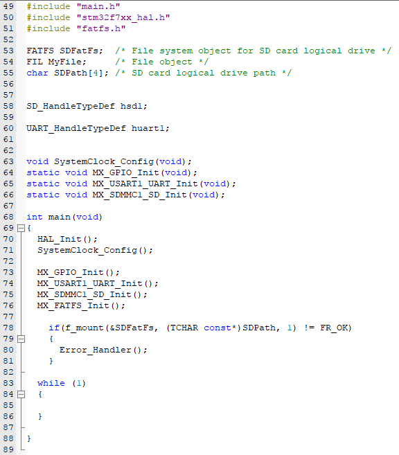

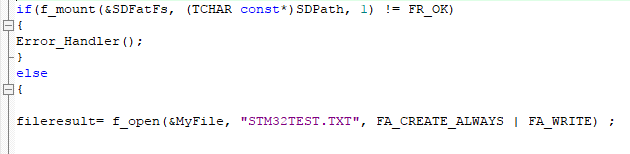

to use the FATFs on the STM32F746NG-Discovery Board, I generate the code using the CubeMX.
this is my main.c file.
during the debugging, I found that the value returned by the f_mount is FR_NOT_READY, so that the function will always fall into Error_Handle();
but with the same board and sd card, the demo project:
STM32Cube_FW_F7_V1.7.0\Projects\STM32746G-Discovery\Applications\FatFs\FatFs_uSD\MDK-ARM
it could work well.
I want to know whether there is any other thing I've forgot to add to the project? Or the code generator itself has a big bug?

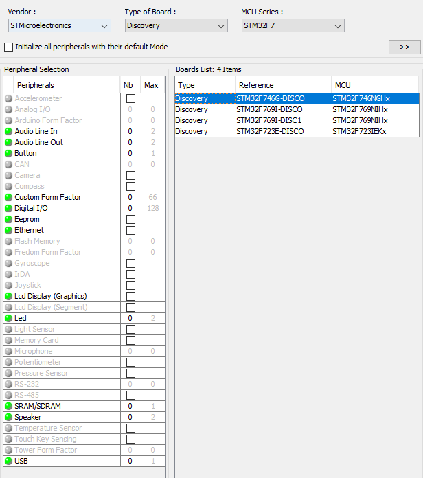

the method i generate the code is:
- select the board
2. config the pinout
and choose the FATFS

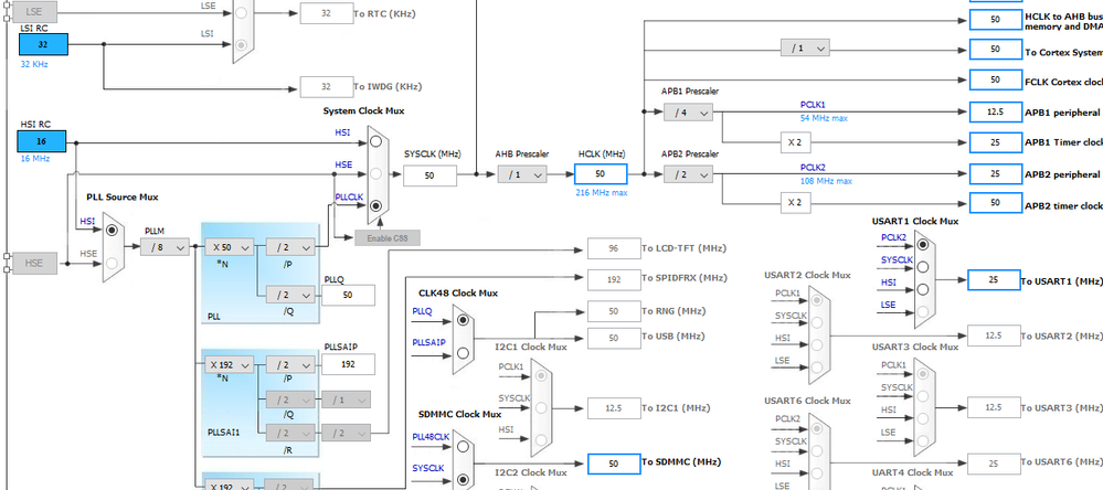

3. resolve the clock

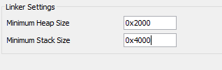

5. change the heap size

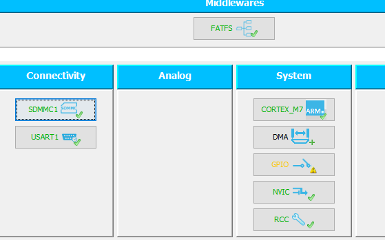

7. and generate the project
8.open project and add this line to main.c
FATFS SDFatFs; /* File system object for SD card logical drive */
FIL MyFile; /* File object */char SDPath[4]; /* SD card logical drive path */if(f_mount(&SDFatFs, (TCHAR const*)SDPath, 1) != FR_OK)
{ Error_Handler(); }and rebuilt it, debug, falls into error_handle.
‎2017-07-17 5:46 AM
taken directly from stm32746g_discovery_sd.c
uSdHandle.Init.ClockEdge = SDMMC_CLOCK_EDGE_RISING;
uSdHandle.Init.ClockBypass = SDMMC_CLOCK_BYPASS_DISABLE; uSdHandle.Init.ClockPowerSave = SDMMC_CLOCK_POWER_SAVE_DISABLE; uSdHandle.Init.BusWide = SDMMC_BUS_WIDE_1B; uSdHandle.Init.HardwareFlowControl = SDMMC_HARDWARE_FLOW_CONTROL_DISABLE; uSdHandle.Init.ClockDiv = SDMMC_TRANSFER_CLK_DIV;so, try 1-bit bus instead of 4 bits
‎2017-07-17 9:56 AM
1. Your suggestion is helpful
Thank you very much the value f_mount returned is FR_OK now. this time I generate the code with SD bus width is 1 bit.
is that mean the CubeMX has a bug when generate the code? it cannot choose a correct bus width.

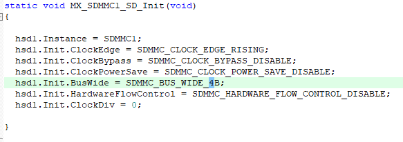

2. how could I use the 4-bit width mode?
and when I trying to modify the sd init function like this
the f_mount function will lead the mcu to here:
and the mcu will stuck at this loop of the function
so, how could I use the 4-bit wide SDIO mode?

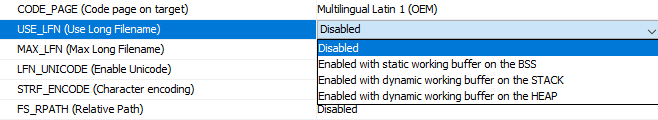

3. f_open return FR_INVALID_NAME. (I just meet this problem but I solved it)
in the 1-bit width mode, after mount the sd card, i add a f_open function but it couldn't work.
the value the f_open returned is FR_INVALID_NAME
This is because the file name I used is too long. when USE_FLN is disabled, the file name must be 8.3 format
STM32TEST has 9 characters >8. so the file name is invilade
‎2017-07-17 4:48 PM
About 4bit wide mode:
As far as I know, MX_SDIO_SD_Init() only sets the SDIO to a known, default state for card initialization -> 1bit wide.
Only during MX_FATFS_Init() will the bus be switched to faster 4bit wide mode. Have a look into BSP_SD_Init(). That function gets called when the SD driver is loaded during FATFS init. In there, a function named HAL_SD_ConfigWideBusOperation() is called. That sets the sdio to 4bit mode - if set up accordingly.
In short: don't change the SD_Init function to 4bit.

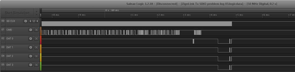

Then I used my logic analyzer to see what is actually happening on the data lines. This is what I see:
First, the clock operates on 400KHz and sends the configuration over the CMD line. On the last few bytes the clock frequency is increased to the much higher specified frequency (which has been lowered in this capture). There's a small pause and the SD card responds on the DAT0 line. Then the MCU sends a bit more data on the CMD line and then the SD card responds using all 4 data lines.
This all happens in the function disk_initialize(fs->drv) in ff.c, line 3036 and this function succeeds. After this function is done, after a few more steps it enters check_fs(fs, bsect); on line 3050. This is where the problem starts. Tracing down the steps in this function takes me to if (disk_read(fs->drv, fs->win, sector, 1) != RES_OK) on line 927, which takes me to diskio.c, line 122 to: res = disk.drv[pdrv]->disk_read(disk.lun[pdrv], buff, sector, count); which returns RES_ERROR.

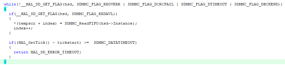

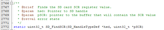

Update: In the working project\application changing the xxx_hal_sd.c in the function HAL_SD_InitCard() so the bus width is 4B causes the program to hang in SD_FindSCR(SD_HandleTypeDef *hsd, uint32_t *pSCR) (between lines 2655 and 2668) trying to get status info from the SD card. It looks like the bus width needs to change depending on what operation is being performed on the SC card.
