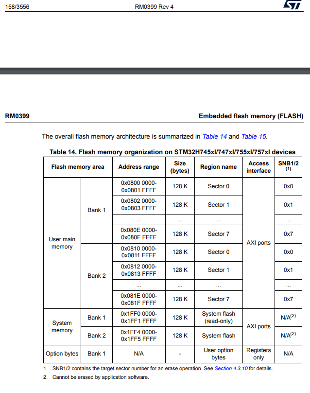

Aren't the Erasable sectors larger than that?
You need to pick blocks which are distinct and uninvolved with your code foot prints.
And use Update methods that don't trash uninvolved sectors. If you provide the methods, you can control the experience..

0x800F000 falls in the middle of a Sector:
https://www.st.com/resource/en/reference_manual/rm0399-stm32h745755-and-stm32h747757-advanced-armbased-32bit-mcus-stmicroelectronics.pdf#page=159

I don't know exactly how CubeIDE decides what memory is its to erase.
As @Tesla DeLorean also mentioned, one way is to simply manage it yourself to ensure that your data is beyond what gets used by the code.
I think that just reducing the FLASH size in the MEMORY section would do that?
eg,
MEMORY
RAM_D1 (xrw) : ORIGIN = 0x24000000, LENGTH = 512K
FLASH (rx) : ORIGIN = 0x08000000, LENGTH = 384K
 So that the tools "think" that there is 128K less than is actually present - and, thus, will never try to erase it.
You then manage placing the data in that top 128K yourself - as previously described...
