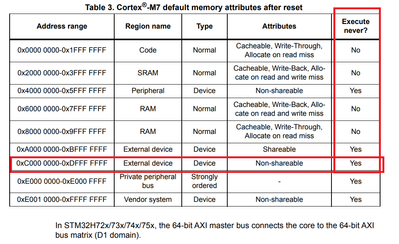

And becarefull if you are trying to execute from 0xD0000000, you will fall also in a fault as that region is Execute-Never as described by ARM. So you need to disable it with MPU.
