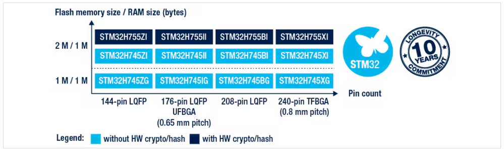

Lucifer37Author
October 23, 2024
I'm using STM32H745

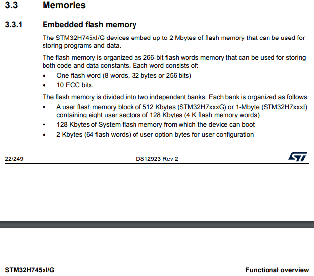

Lucifer37Author
October 24, 2024
Hi Andrew Neil,
I'm using STM32H745ZIT3.....I don't know you understood my requirement or not, This EEOPROM Emulation seems
different concept, it uses different approach like when power is off we able to access same data from same code
when re-program or dump new program-2 it will erase that config data
I'm using Linker script to store config data in specific region.......
Program-1
| config data   |
| store @        |
| 0x0800F000 |
|linker can do |
|define sec     |
STM32 Flash
| source code | 0x08000000
| code End      |
|-------------------|0x0800F000
| Config data   |
-------------------|0x080FFFFF
Program-2
|Access the    |
| config data   |
| store @        |
| 0x0800F000 |
