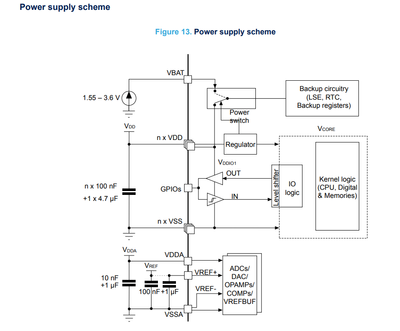

I am using STM32U083 MCU in a project that runs on a 3.6v Li-SOCL2 lithium thionyl chloride battery (OC voltage 3.65V / Nominal voltage at 1mA 3.6V).
Currently I have used a LDO of 2.5v to power the MCU, but I was thinking if we can eliminate the LDO and directly power the MCU from the battery.
Going through the datasheet I have found that the recommended input supply voltage is 1.55v-3.6v, and max is 4.0v, I have seen a mass produced device using the same battery directly on a STM32L053 MCU. I am expecting the same might be possible with U083 as well.
Please suggest if this is okay or is there can be any potential issues that can happen.

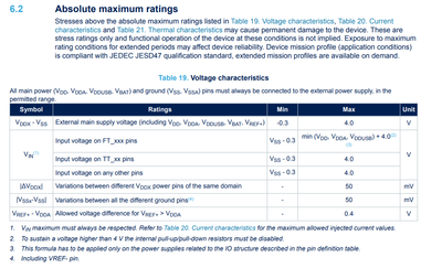

max is 4.0v
As your screenshot shows, that is the Absolute Maximum - that's not a guaranteed operating voltage.

Hi @Andrew Neil, the product is competing in the same low cost market, but I didn't wanted to gamble so I asked here in the community, as I have mentioned even though the absolute max is 4.0V our system absolute max is 3.6v-3.7v in normal operation it will never exceed 3.6v,  which is just at the corner of operating voltage(3.6v) given in datasheet. So I was doubtful if we can use the MCU in such a corner condition safely. I believe it is perfectly safe as the absolute maximum is around 4.0v as confirmed by @Ozone.
