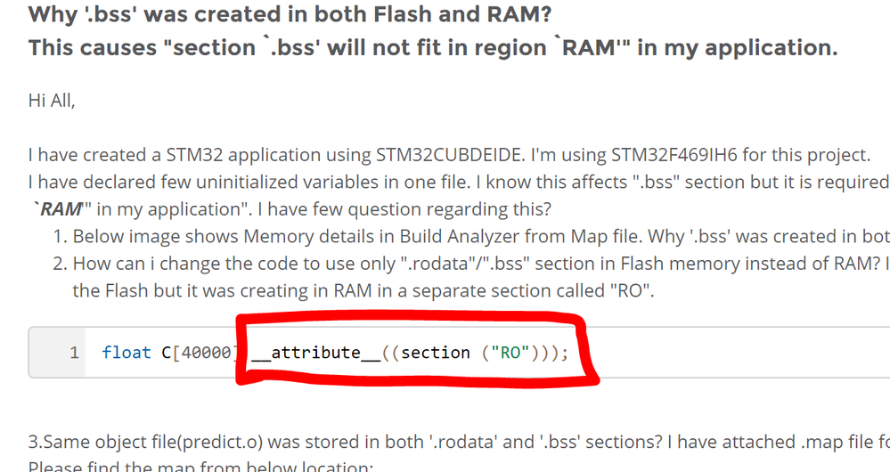

In second paragraph, you mentioned uninitialized variables are not stored in FLASH. But it seems not true. Uninitialized variables are resides under .bss section. And this will be created in both FLASH and RAM. I posted one question similar to this. Please take a look at map file from this post.
https://community.st.com/s/feed/0D53W00000FzIanSAF
​In the MAP file you can see .bss section was created in both FLASH and RAM.
Obviously if you tell it to be stored in the read-only section, that is where it will be stored.
You're telling it to store an uninitialized, non-const array in a read-only section, which is nonsensical.
Remove the attribute, use a default linker script, and it will indeed not store uninitialized arrays in FLASH.

I have not used any attribute and I have default linker script only. Not changed explicitly anything.
Also, Did you get a chance ​to look at map and linker filers in above mentioned link?
If you see the map file, it has .bss sections created in both FLASH and RAM.​
