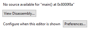

I'm trying to profile my application which running on STM32F469IH6 micro-controller.
I'm able to run the application in debug mode and able to see the timings of the applications.
But In generally running application in release mode will have more optimizations included compared with the debug mode. But If I run the application in Release mode then i'm encountered with below error.0693W000003PSBYQA4.png
Below is log at the time of running application in release mode:

If your application runs fine in Debug, but not in Release, this typically indicates there is an bug somewhere that doesn't get tripped by Debug mode. This could be due to reading uninitialized data, a race condition, or something else. There is not catch-all solution. You'll need to debug the program and determine where/what is causing the issue.
Just because it works in Debug mode doesn't not indicate there are not bugs.
Your log shows the program was downloaded successfully. No information there.

If you mean 'no source available for main()' is an error, it's not.
It's just the result of stripping symbol information from the application binary, which is usually done for release builds.
If you need (debug) symbols also for release builds you've to adjust the linker flags accordingly (e.g. remove the -s option for GCC toolchain).
I don't know if there is also a Cube config item for that. I don't use Cube.

Hello. Problem that source file can't be found can be related to missing debug information. Check your compiler settings for release.
