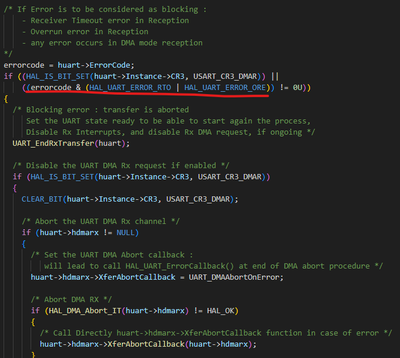

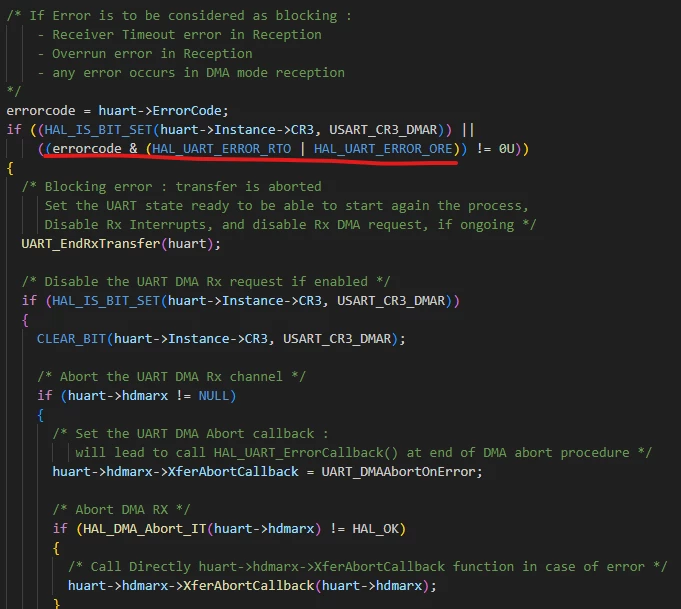

HAL Version used - 1.10.0
I am using RTO interrupt to identify if the transmitter has finished sending a packet.
In the IRQ handler "void HAL_UART_IRQHandler(UART_HandleTypeDef *huart)", this is considered as an error and it is aborting the ongoing DMA transfer from the UART peripheral to the memory. This is causing issues on our side.
The same is also posted here.
https://community.st.com/t5/stm32-mcus-embedded-software/is-implementation-of-rtof-support-botched-in-hal/m-p/166118
Why is this implemented it in this way ? Are we not supposed to use RTOF to identify if the transmitter has finished transmitting the packet ?
In the error callback you can check huart.ErrorCode & HAL_UART_ERROR_RTO to find the error reason.
Short answer - because the RTO event signals end of packet, therefore end of transfer. You can then restart RX, possibly into a new buffer.
Even shorter answer... the UART "HAL" driver is not considered production quality - at least by some people on this forum. OK for a quick test of the hardware.
Thank you @Pavel A. for your prompt reply. My concern is that the handler "HAL_UART_IRQHandler" is aborting the ongoing DMA transfer (HAL_DMA_ABORT_IT()) and I am loosing the data. I have configured DMA for my UART. Is there any workaround for this ?
Pavel A.
Make your own driver, or decrease the RTO timeout, or react faster to the RTO event to minimize the window from the timeout to the next RX byte.
You can use IDLE to detect the end of transmission instead.
