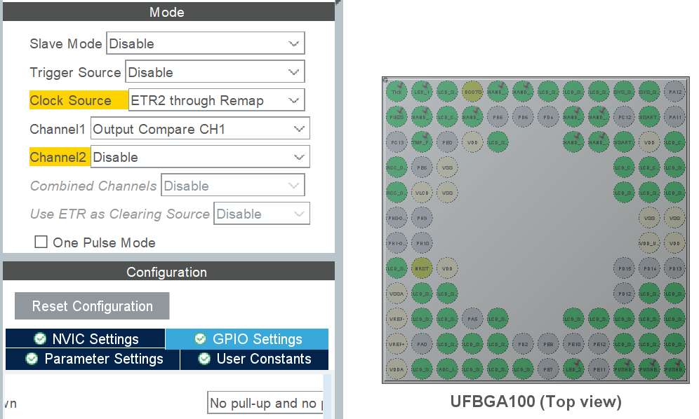

The configuration I use to measure frequency. (TIM22 with LSE)

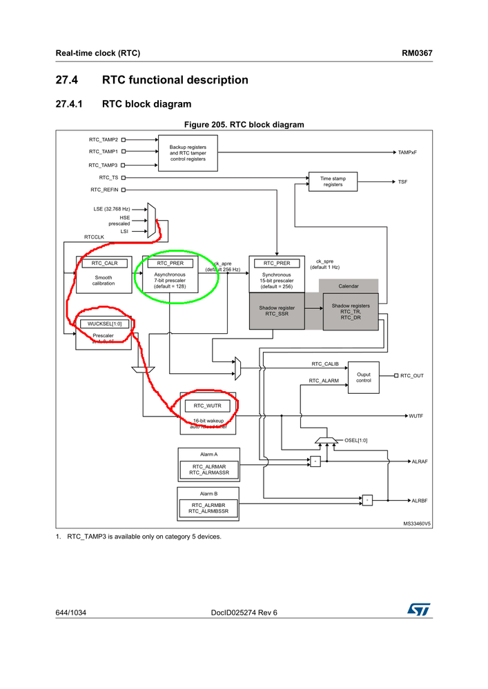

> I set the rtc to have an interuption every second
Using wakeup (RTC_WUTR)? And if yes, then how is RTC_CR.WUCKSEL set? If to 0b0xx, then that's the problem: wakeup is derived from the raw RTC clock source, avoiding the calibration.
If this is the case, try to WUCKSEL to 0b10x.

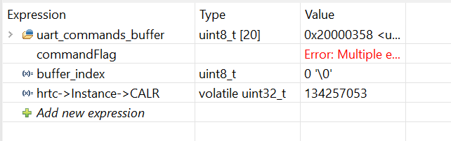

waclawek.jan
June 21, 2021

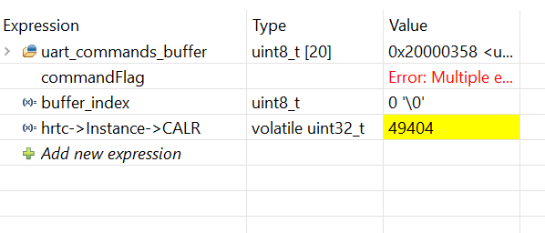

Read out and check/post the RTC registers content before and after the calibration.
How precise is your frequency counter and what is its resolution?
STM32L0Fan
June 21, 2021
Thank you for your answer, I am not sure If this what you wanted.
0693W00000BbZ0JQAV.png0693W00000BbZ0EQAV.pngMy frequency counter is precise 9 digits and (it's the HM8123 frequency counter) resolution of 10^-8 for this application I think.

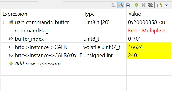

Léo
STM32L0Fan
June 23, 2021

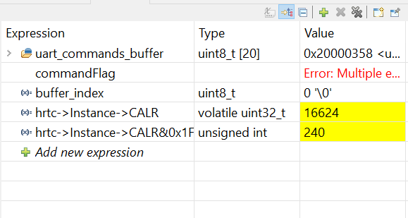

I added a mask to propely view the value.0693W00000BblD0QAJ.pngI don't know why the calibration don't apply maybe there is something to initialize to make it work ? I don't know I'm still stuck ...

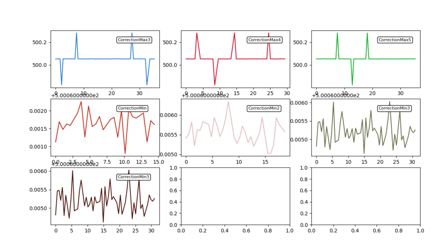

STM32L0Fan
June 24, 2021

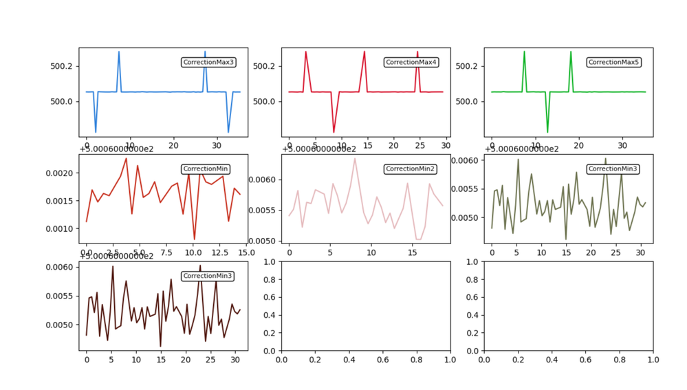

I set the rtc to have an interuption every second and I am changing the value of a GPIO pin, that's the best way I found to read the RTC frequency.
Here are my readings :
0693W00000BbsQuQAJ.pngx: time in minutes
y: frequency in mHz
nb: for the 3 graphs on top I put the max value in : HAL_RTCEx_SetSmoothCalib(timeMgr.rtcHandle,
RTC_SMOOTHCALIB_PERIOD_8SEC,
RTC_SMOOTHCALIB_PLUSPULSES_RESET,
0x1FF
and for the min graphs I put 0x000

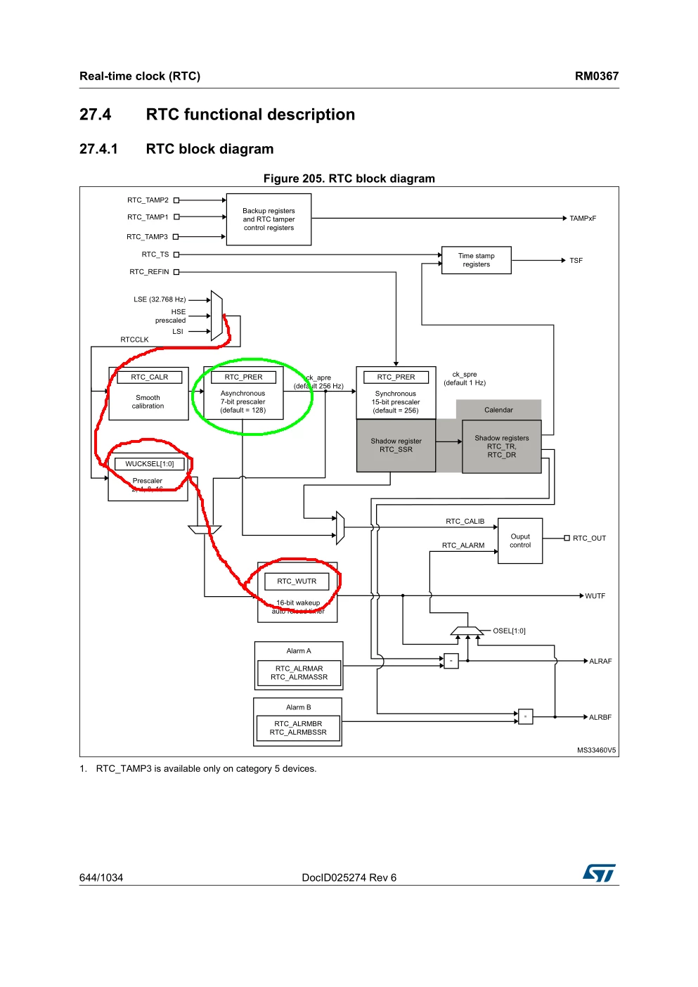

waclawek.jan
waclawek.janBest answer
June 24, 2021
STM32L0Fan
June 24, 2021
Thank you JW that was it, indeed now I can see the effet of the calibration.

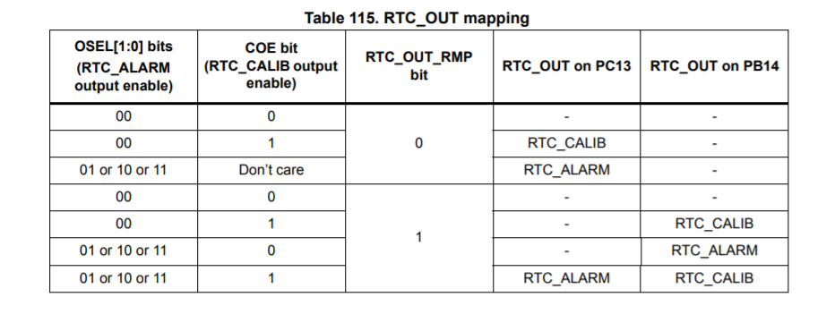

0693W00000Bbvs3QAB.pngI started to wonder If i was obligated to use the pin PC13 to have the result I wanted. But it seems that your way is working too.
