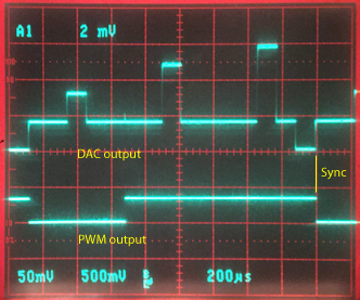

It's a STM32L053R8 (Nucleo64) and i am using a DAC with circular DMA to generate an analog waveform. Now i need to use a PWM timer to generate some digital output signals synchronous to the DMA cycle. Can i use two pins to route the DMA interrupt to the PWM timer? Is there on-chip circuitry for this?

Meanwhile i learned that the DMA interrupt is jittery, so no good for timing. Anyway the DMA counter isn't directly related to the DAC output, as it feeds the data holding register. Probably one needs to disable interrupts and start the DAC trigger timer and the PWM timer "at the same time" and hope they will remain in phase, except a constant phase error of some instructions. Maybe one should implement the DMA interrupt and check the phase relation, with a recovery procedure in case of error.

The solution i found now uses Tim6 to trigger the DAC (and its DMA, 15 samples) and Tim2 to generate the PWM signals. In order to synchronize DAC and PWM i am using the fourth channel of Tim2 in capture mode with Comparator2 to trigger on a feature in the DAC output waveform. So there is a wire from the DAC output pin to the comparator input pin. The capture interrupt handler implements error recovery in case one of the two timers or the DMA source address counter falls out of sync (primitive PLL).
